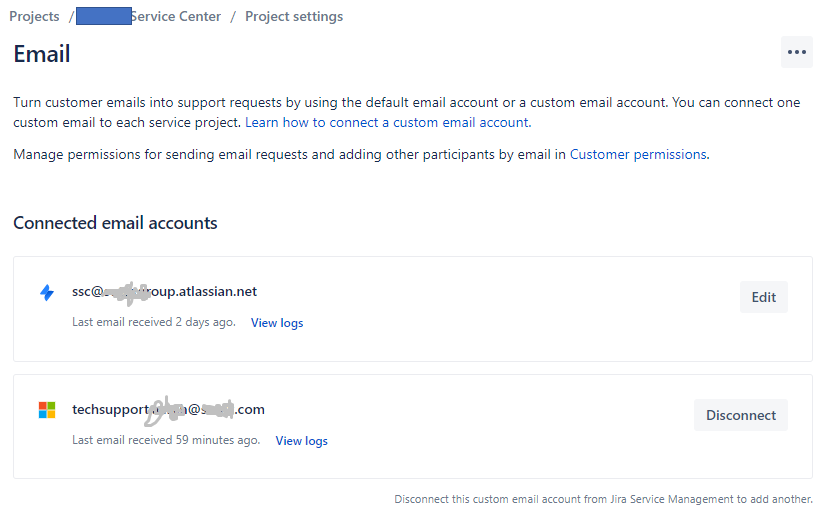

Hi all,
How i can build an automation depending of the receiver address? We need four additional connected email accounts:
1@abc.com
2@abc.com
3@abc.com
4@abc.com
if somebody write an eMail to 1@abc.com, the generated issue should appear in the Queue "1" etc.
I don't know the query for the receiver address for building my automation... has anybody an idea how i can solve this issue?
