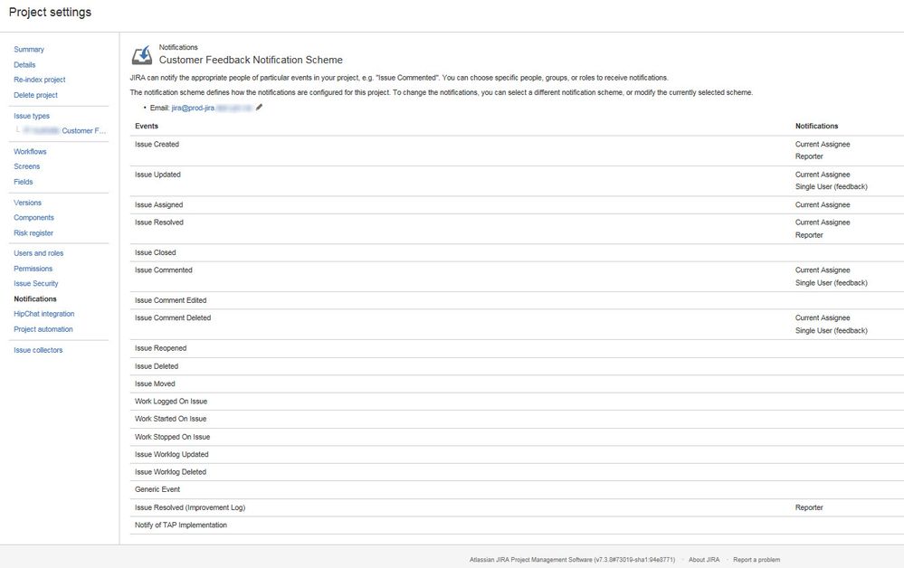

Chris Banks
February 14, 2019
That looks useful, but I'm not sure how to get to that screen
When I go the Project Settings page, what I can see is this:
There are no options that look quite like your screenshots. As you can see, Issue Created is set to notify "Reporter".
Payne
February 15, 2019
You tagged this question as Jira Service Desk, but your screenshot looks like a core or software project, rather than a service desk project; if that's the case, then disregard my guidance.

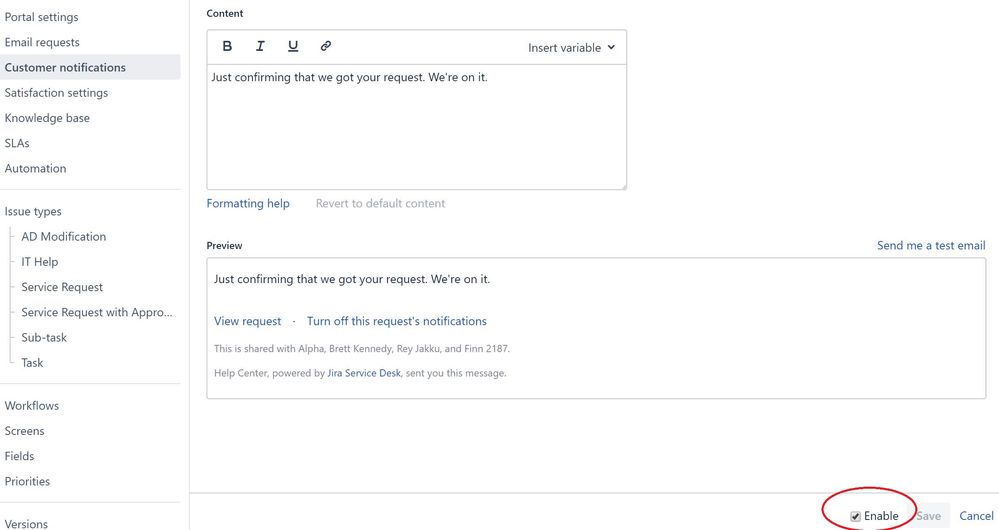

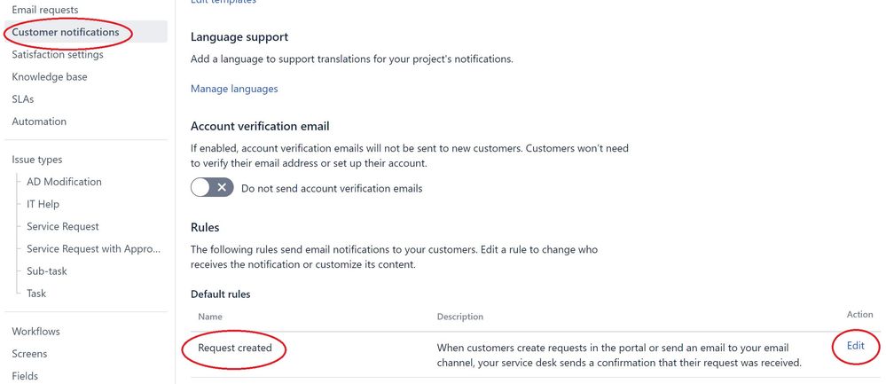

Payne
February 13, 2019
Is the Request Created notification enabled in the Customer Notifications area of your project configuration?
