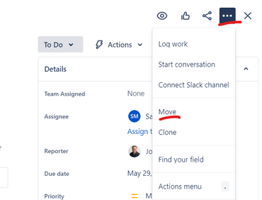

On the issue itself, click the three dots menu in the upper right and select Move. Then you can move the issue to another project.
Thanks. I was able to do the migration, but the reporter can no longer track it.

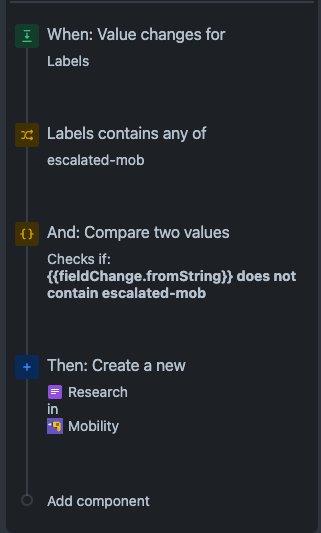

When I add the escalated-mob tag to the topic, it opens a topic to the Mobility project. I would like to see the updates made on the topic opened in the Mobility project, on the topic in my own project.
When I do this, it connects to the problem in the other project. But the update made in the connected problem is not updated in the problem in the other project.
When the rule I just shared happens, it both opens a new problem to the other project and establishes a connection.
The changes made in the new issue opened in project B depending on project A are not updated in project A.
So that will need to be a second rule. Create that based on Field Value Changed. Then add a Branch for Linked Issues - identify the link type(s) if needed.
Then add an action for Edit Issue, select the field and then say copy from Trigger issue.
