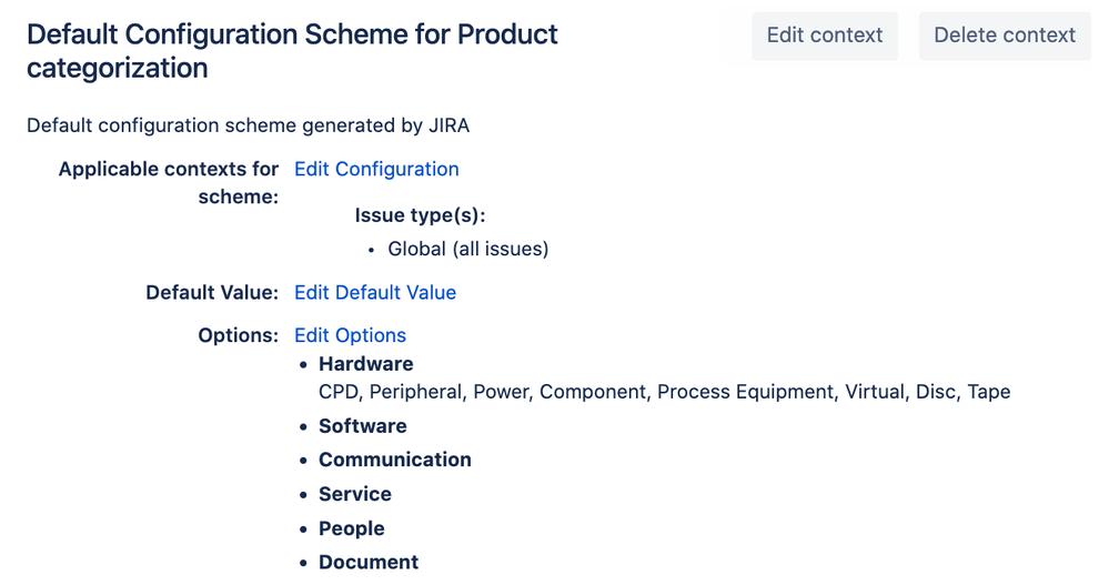

for Product:

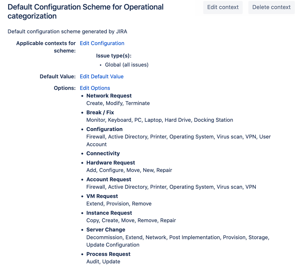

Screenshot 2022-06-12 at 19.11.53.pngand for operational:
The main thing I derive from those preset values, is what they are intended for. While you can use product categorisation clearly to approach your tickets from the viewpoint of "what tangible item is this request about", the operational categorisation rather starts from "what do you, service desk customer, want us to do for you".
The many templates JSM offers are in the box to make it easy for users to spin up a service desk that is operational in no time. And, while that is awesome, the reality is that you would usually have to do some tweaks to make the thing work for your situation.
Basically, you could even forget about these fields entirely. In the end, the title of your request type could cover either approach. But I would recommend to be consistent and, when you start defining the request types that your customers will actually have to use, offer them one of both ways to contact you. Which is best, will be very much defined by how you prefer to interact with your customers (in the first place) and how you triage work to your internal service teams.

Product categories appear to be geared to 'what has broken', whilst Operation categories appear to be more 'The action to be performed'.
