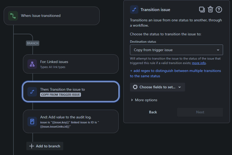

I am attempting to:
  • Change a JSM issue status to match a JSW issue status when it's being changed
Current working setup:
JSM (project A)
  • Issue is created
Automation:
  • Create a new issue in JSW
  • Link the new issue as "relates to" to the JSW issue
JSW (Project B)

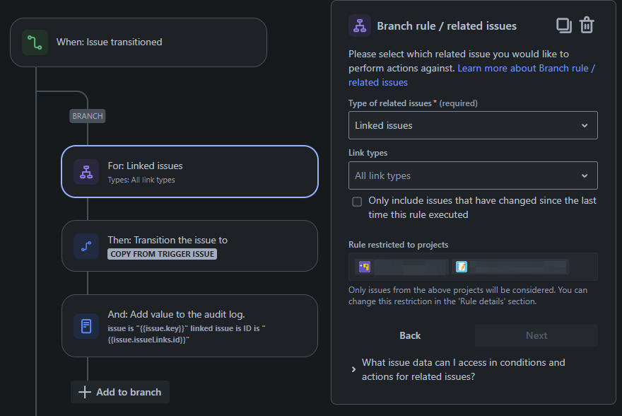

Automation:
  • BRANCH
  • When: Issue transitioned
  • Then: Transition the issue to COPY FROM TRIGGER ISSUE
Here the automation configuration which is in a Multi-project scope for both the projects Project A and B.

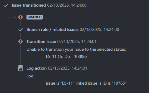

2025-02-13-Audit log - Automation - Jira-002697.png2025-02-13-Audit log - Automation - Jira-002698.png
The problem is I am getting this error when changing the status in the JWS issue.
I also created all the matching status fields in the workflow in the JSM project.
Do you have any ideas what the problem is? The error message is not really that helpful...

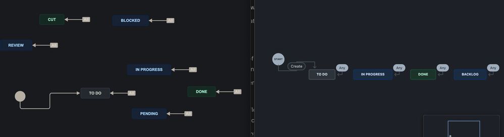

@Mario Capellari , Welcome to the Atlassian Community!
Things that you may need to consider:
- If you have an available transition to the destination statuses
Let's say that your current status in your JSW issue is To Do, so Jira will not to make an auto transition for the same statuses.
Now let's say that your current status in the JSW issue is In Progress, you need to make sure that you have an available transition connecting the In Progress and To Do statuses.
If you don't have available transitions connecting your statuses, the automation will not be able to operate your transition.
Have you checked this?

I did check to make sure the structure of the transitions match - here both workflows - JSM on the left, JSW on the right.
Mario Capellari
February 13, 2025
Instead of using the Branch iterative values for all statuses, I replaced it with specific "In Progress" and "Done" statuses. Same setup otherwise, and that works now.
So the problem seems to be in the list the Branch is sending to the Transition node.
