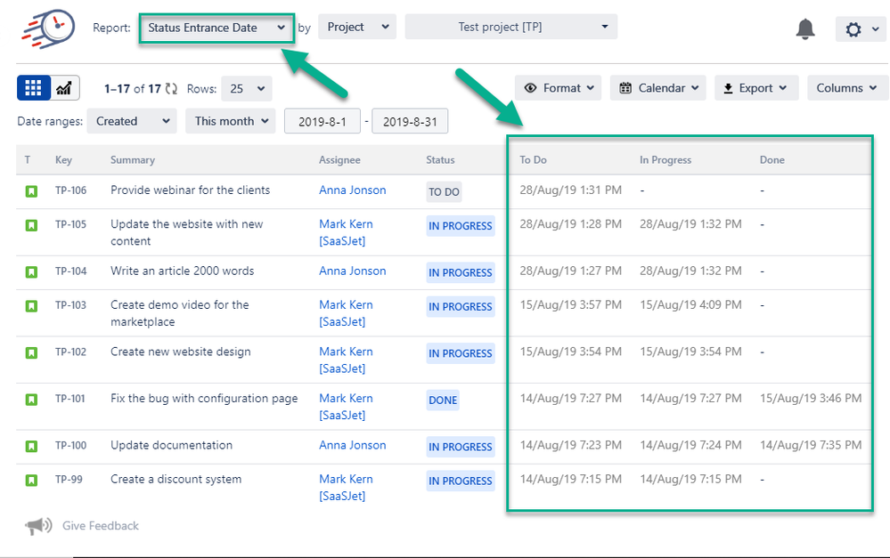

You can consider solutions from Atlassian marketplace. There are 2 apps that can help in your case:
1. Time in Status for Jira Cloud and its Status Entrance Date report. Here you'll get a date on when an issue was closed, or when it entered any of the statuses.

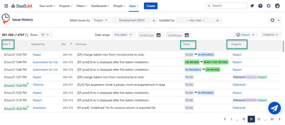

2. Issue History shows all the history changes that have been made to each issue. Here you can get the time when the issue was closed, when it was assigned to someone, or any other changes.
These add-ons are developed by my team, so let me know if you've got any questions.
