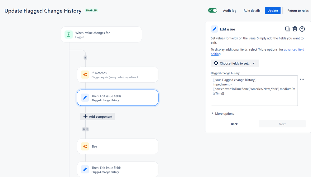

We do something similar by creating a custom Paragraph field (multi-line text) and then update it whenever we put something on hold or flag it for some reason. We don't use different date fields for it. Then we add an automation rule to populate it. Here is an example:

So if I understand correctly, it is possible that whenever someone transfers the status to "On Hold" that the current system date gets written in multi-line text field, correct?
John Funk
April 10, 2024
Correct.

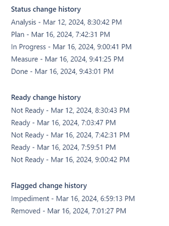

Here's an example of the result:
