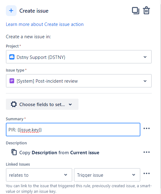

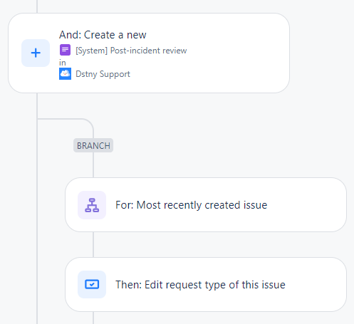

Here's the flow that creates the PIR:
It creates the PIR case based on the Issue type 'Post-incident review':

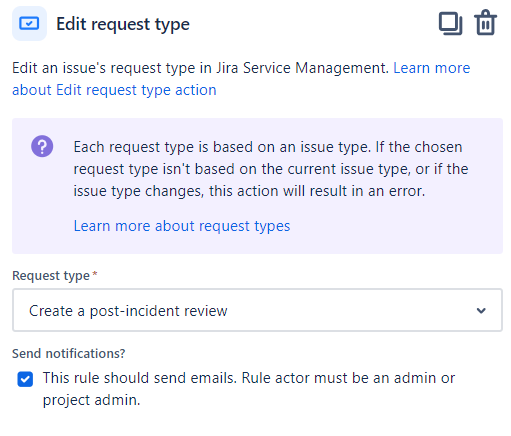

In the branch, we are trying to set the Request type:Screenshot 2024-01-12 161528.png

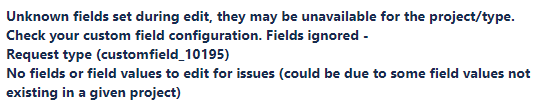

This produces the following error:

I am still having an issue.
When I first used the action to update the Request Type, I received the error shown above. This gave me the name of the custom field.

Thanks. We finally discovered the issue was that, when attempting to use the 'Edit the Request type' action, it was reporting an issue against an incorrect customfield name.
When we went in to look at Request Types linked to Issue Types (Atlassian admin level) we discovered the correct customfield name and used that in the json to amend the field. We also had to you the code that represented the value rather than a string of text.
