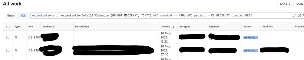

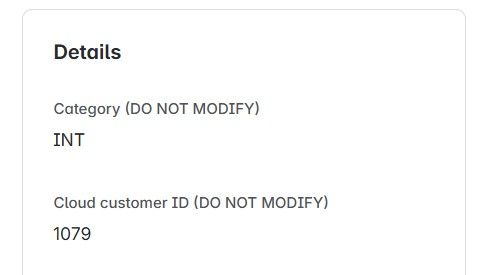

Alain Kovacs
May 20, 2025
So these are the details of one of my customer organizations:1.jpg
Then my JQL is like this:
organizations in organizationDetail("Category (DO NOT MODIFY)", "INT") AND created >= -30d AND project = CS ORDER BY created DESC
