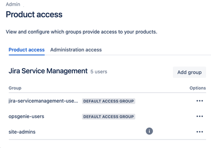

Can you please check on Cog icon > User management > Product access if the OpsGenie group is listed there?

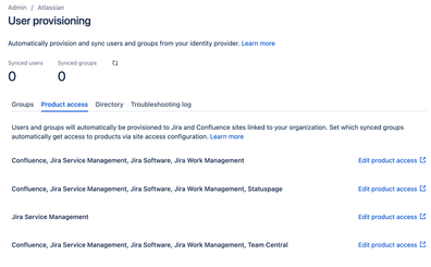

When configuring user provisioning, it shows some groups as well that users will be added, is OG listed there as well?

@Angélica Luz
See screenshot- opsgenie group is not default access group for JSD. Also any feedback from the Opsgenie team on whether this can be disabled?

@Angélica Luz Is the screenshot of user provisioning from Atlassian Access?

I was waiting for the details from David for the next steps, and now with your comment, I went ahead and shared it with the Identity team.
My second screenshot is from user provisioning, but just the first step of the configuration. I'm unable to test this feature due to limitations regarding domain and identity provider, so I escalated this case to the Identity team to check if there is a way to disable the OpsGenie invitation.
