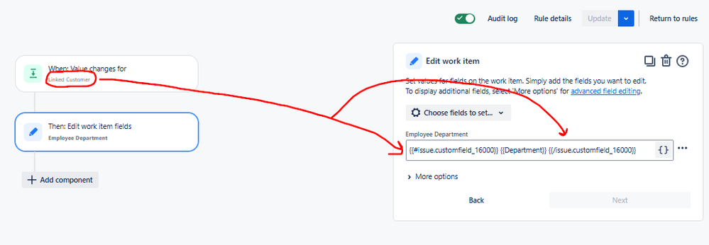

I'll provide an example of what I think you can use to pull the approver but in my case I just needed to pull the department.
So you will need a custom field tied to your application schema, and then when an application is linked to your service request you should be able to pull that business owner attribute using the method I use to get a customer's department above.
The issue.customfield will be the field on your service request that is used to link the application asset.
{{#issue.customfield_XXXX}} {{Business Owner Attribute Name}} {{/issue.customfield_XXXX}}
This can be used to edit your approvers field (or whichever field you have your approval workflow tied to)

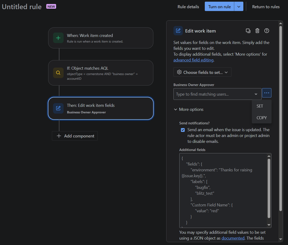

Thanks @Christopher Yen . With the recent update to Jira I don' see the option to use a JQL for the "Edit work item" option. This is where I am stuck. AddApproverAssets.png

If you type the smart values into the Business Owner Approver section I think it might prompt you with "Smart value [smart value that you entered into the box] " that you can select

       ◘ The issue is trying to see how to update the custom field with the value from the Jira asset. There is no option to update the field using a JQL or AQL.

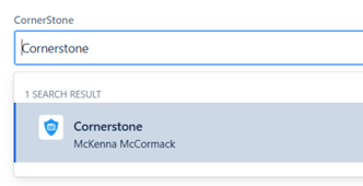

◘ There will be two types of requests; one where the submitter can choose the application, and the other request is for single applications. We are wanting to pull the approver from the Business Owner attribute.
Can you show an application objects config from within Assets?

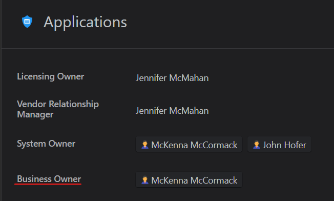

◘ Here is a screenshot showing the attribute within Assets.
◘ I created a custom field for Cornserstone so that the assets are shown in the request form.
Is the Business Owner attribute a user attribute or other?
◘ It is a user attribute

Add an action lookupobjects action in the automation rule.
  • Set the schema value to the schema where the applications are listed
  • Set the AQL to key = "{{customfield_xxxxx}} (customfield_Id of the CornerStone field)
So in the automation the Business Owner Approver field can be set using the smart value.
Use an edit action on the field Business Owner Approval.
  • smartvalue: {{lookupObjects.Business Owner.<attribute containing the Jira user>.accountId}}
As I see the Business Owner as a reference to an other object, is on that object a Jira user linked and in what attribute?
