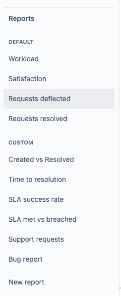

I don't see that in the list of reports form the JSM project I just created.
Maybe it comes with a particular JSM project template. Do you recall which one was used to create your project?
Can you click on the Edit Report option and show us the configuration for the report?

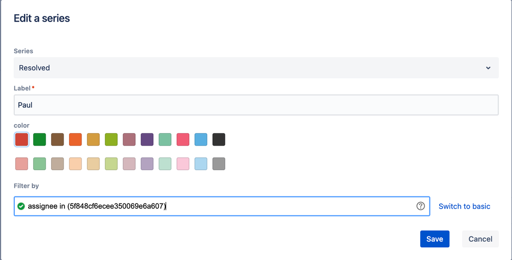

Sorry, I was mistaken, the report is a custom one but I am using a predefined series, Resolved in this case.
I am using a series for every agent in the team that look like this, very basic as you can see.
Is there anything in this configuration that I can change to get the results that I am looking for?
