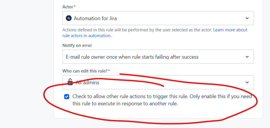

For anyone else running into this problem there's a check-box at the bottom of the Rule Details pane "Check to allow other rule actions to trigger this rule..." This was the problem. It took more reading of similar issues and someone's enlarged screenshot to bring this option to my attention, and after setting it the rule behaved as expected.
I've attached a screenshot

@Justin Ostafew - yay, glad you figured it out! That was going to be my next suggestion - it's a useful checkbox to leave UN-checked if you want to avoid a spiral of neverending issue creation in two projects. 🤣
