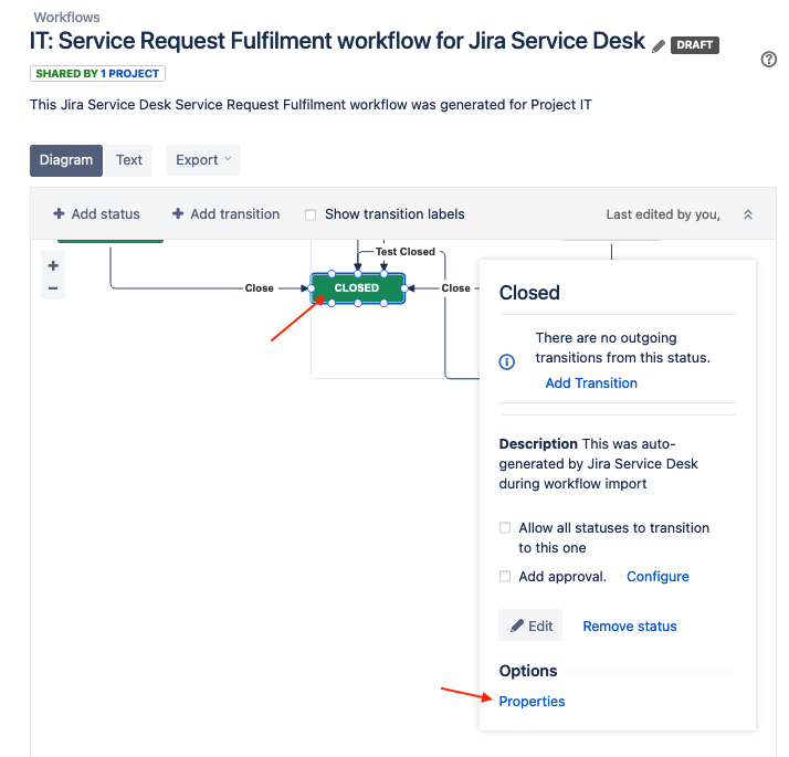

If you are using a company-managed project, go to Project settings > Workflows and click on Screen Shot 2021-05-27 at 15.15.48.png to edit the workflow.
Select the Diagram mode > Click on the desired status > Properties.

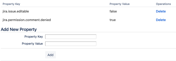

It’s necessary to add two properties: one for comments and another one for other fields.
Property Key = jira.issue.editable
Property Value = false
Property Key =  jira.permission.comment.denied
Property Value = true
After that, publish the workflow and the changes will be applied to all tickets that use the workflow you edited.

Pablo Viñas
May 28, 2021
Muchas gracias por el comentario.
Ha funcionado correctamente como necesitaba.
