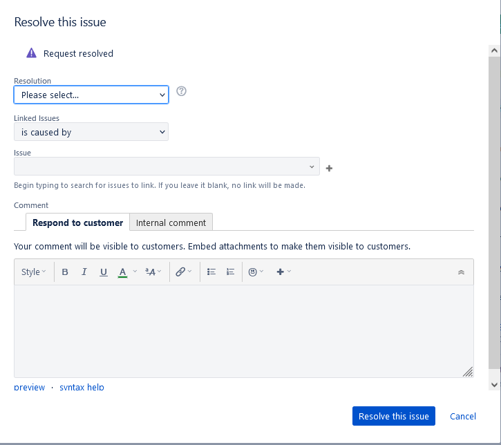

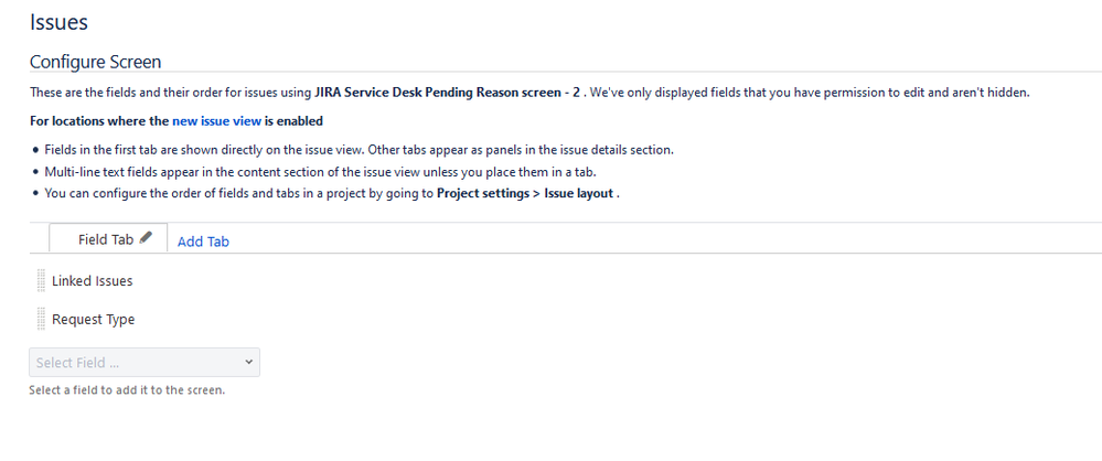

I'm trying to add any new field to our resolution transition screens that are already associated with our existing workflows in place.
I was using all the default workflow and screens before and this is the first instance of customizing this particular screen. I have added it to every transition screen available and it never shows up when transitioning from any of the workflows. Specifically trying to add the built in Request Type already associated with the Issue types and workflows.
Is it possible that they need to be published in someway from the workflows or schemas? There is no draft status of these screens like there are on workflows but I have no modified workflows in anyway.
I have tried different fields but only the default values show up on the actual transition screen (pic 2)

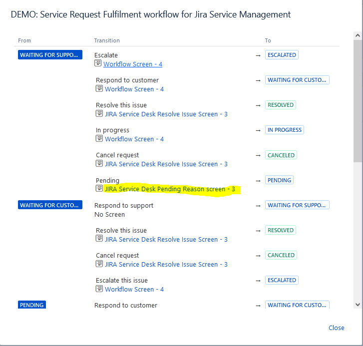

If you want a field to show on a transition screen then you need to associate the screen with the transition. This is done in the workflow if you click on the transition and edit that transition you’ll see a modal pop up with name, description and screen. The last field is where you associate the transition screen. Now if you want any of the files that appear on that screen to be required then you would add a validator for each required feel as part of that transition.
Michael Quarters
July 7, 2021

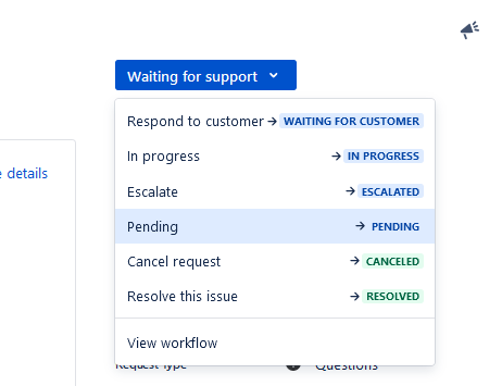

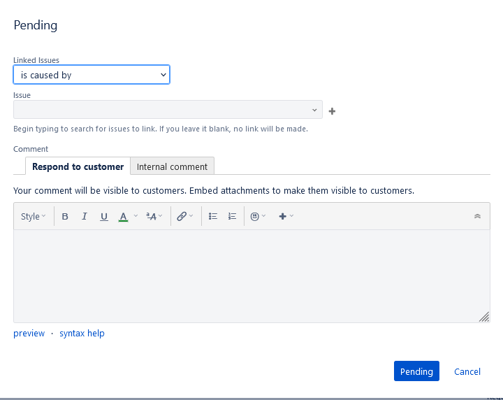

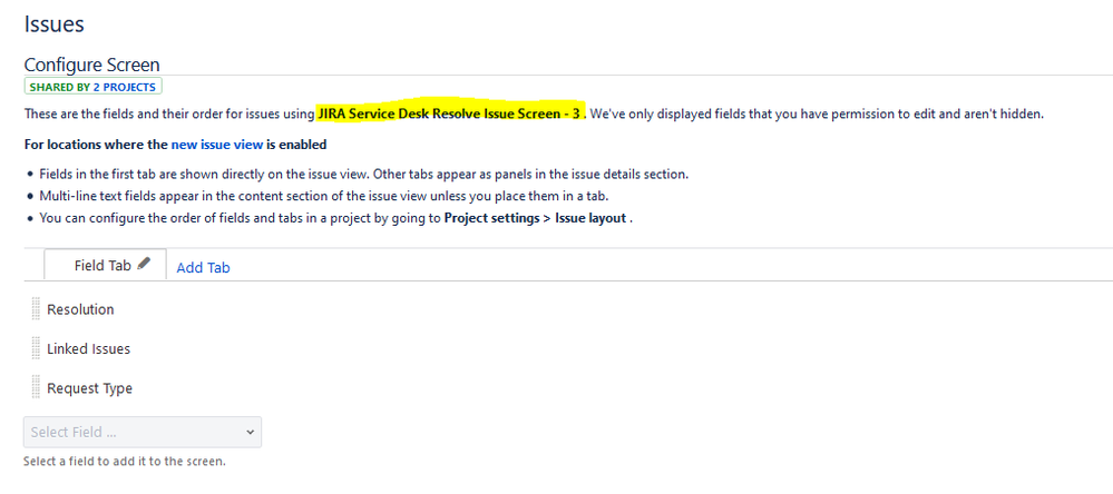

the transition was already associated with the screen i was modifyingscreen 3 fields.PNGscreen 3 workflow.PNG screen 3 transition screen.PNGscreen 3 status.PNG
Jack Brickey
July 7, 2021
first image refers to Jira Service Desk Resolve Issue Screen - 3 while he workflow refers to “…Pending Reason…”.
Michael Quarters
July 7, 2021
Agreed but i have added this field to every single transition screen associated to a workflow and am bad at highlighting. The Workflow + screen association still shows the correct association, just 3 lines up.
