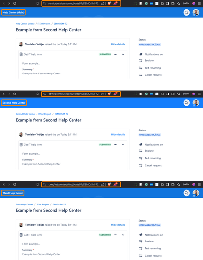

Tomislav Tobijas
November 7, 2024
Hi @Humberto Gomes ,
I was thinking of getting that information from smart value or API, and from what I've found there's a web link to a customer view of the ticket. Then you could potentially parse that link to get the portal and store that info to some field. However, no matter which help center you use to raise your ticket, the web link that's accessible in the background is always the one to the ticket on the default help center (again, no matter where the ticket is initially raised).
That got me thinking and I've realized that the ticket is actually visible in any help center (if you have access to each). This is news to me so I just wanted to share it here. 👀ticket-visibility.png
I didn't manage to find a suggestion on JAC, based on your initial question. If nothing, I would recommend reaching out to support for some confirmation and maybe they can raise a ticket for you.
