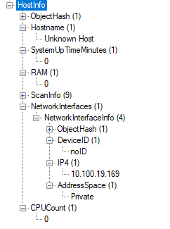

However, when I look at the scan result file, I do not see this information:
After talking with Atlassian, they instructed me to use the SNMP Extended Values list scanning method to scan for these additional attributes. I may be incorrect in my understanding but as long as I am using SNMP_GET or SNMP_WALK to scan for attributes that already exist in the DeviceInfo-Object, like Serialnumber, Hostname, Model, and Vendor, I shouldn't have to use an ExtendedInformation list to map to object attributes. Looking in the ObjectHashSettings.xml document, that should be the following attributes.

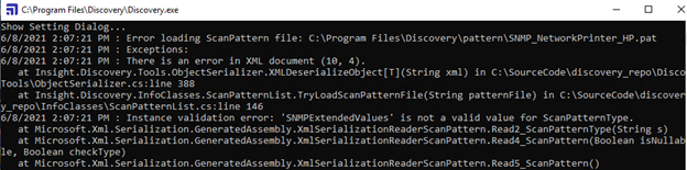

Please let me know if I am thinking of this incorrectly. I did try using the example SNMP Extended Values Scan type using the provided example in the documentation but when I try to execute it, I get the following error.
Original Pattern File:

matthew barrett
April 21, 2026
I know this is really old, but I was just doing this exact same thing for my Canon printers and its working. I think the error was related to grabbing Hostname and not FQDN. The new default SNMP templates substring the FQDN to use for the hostname field and using that as the base for a custom template lets me grab lots of custom OID fields from my printers.
