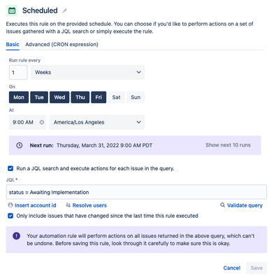

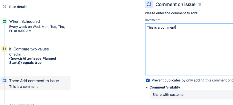

No worries, so this is what the automation would look like:
This would run every workday at 9 am and only look at issues in the Awaiting Implementation status (the picture is missing the "" around the status, and if you want to narrow it down further you should add the issue type in there as well...).
If there are issues returned by that query, do a date compare between now and your Planned Start (and yes, that is a smart value) and if it returns true, add a comment to the request. It is set up to share that comment to the customer, but you can make it internal, that way only the assignee and watchers will see it.
