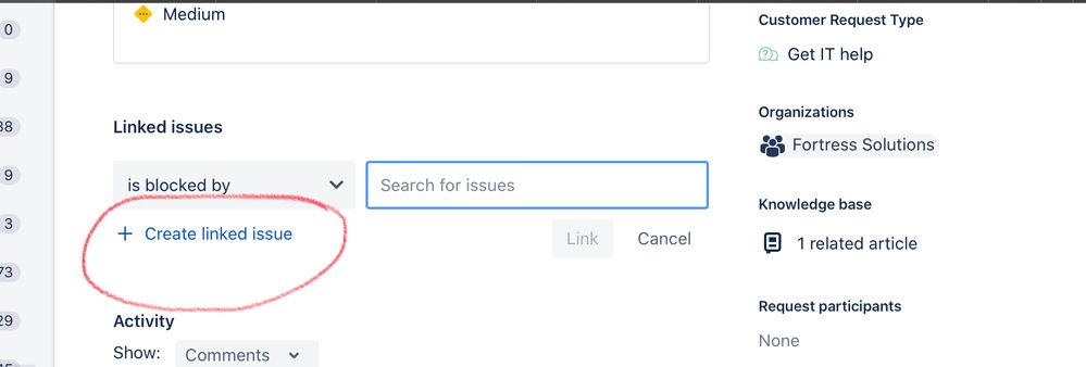

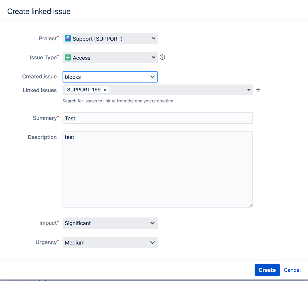

Jack Brickey
July 10, 2020
This need to be a new question/post.
there a number of things that will drive the right answer here but assuming you are on Cloud and you are using a Classic project then once you click on the link issue icon you should see a link to create linked issues as below.
