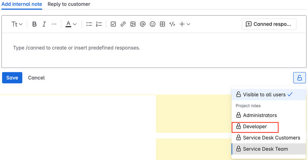

Hi everyone,
I have created a Role "Developer" and now via the lock at the bottom right of the comment I select this Role so that only those in Developer will see the comment.
Now I would like to make this massive change on all old comments as well. Is this possible? also is it possible to distinguish internal tickets from public tickets?

FrancoB
June 19, 2025
No I don't want to change the Default one, but the one of already created tickets.
I thought you could via api but I can't find info

FrancoB
June 19, 2025
Hi Akriti Sagar,
thank you for your response.
Yes I have access to Jira Cloud Premium.
So I could use an automation, could you give me more information?
The modification I would like to replicate is this
