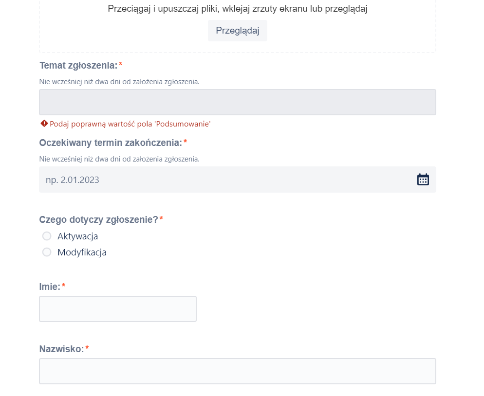

I do not know what happend.
Why I can send/create requests in protal with empty mandatory fields?Adnotacja 2023-01-02 113435.png
3 votes

Anna Arczynska
January 2, 2023
Are you illustrating that the issue is created with the three fields left empty?
- YES
Can you indicate the source of the screenshot? Is it from project setting > request types or somewhere else?
- Screenshot was done in portal on already created request.
 What is the behavior if you use the Create button?
- Request was created, empty mandatory fields were not marked, no error message.
It is about service request.

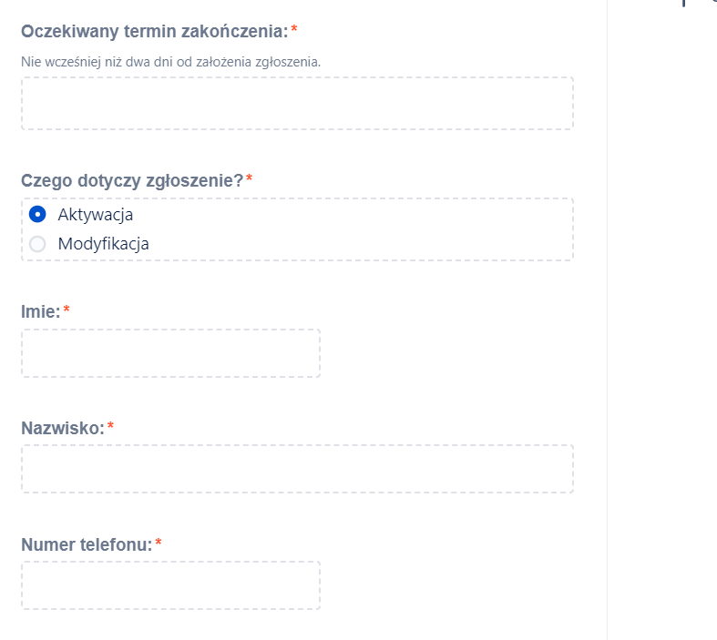

Anna Arczynska
January 2, 2023

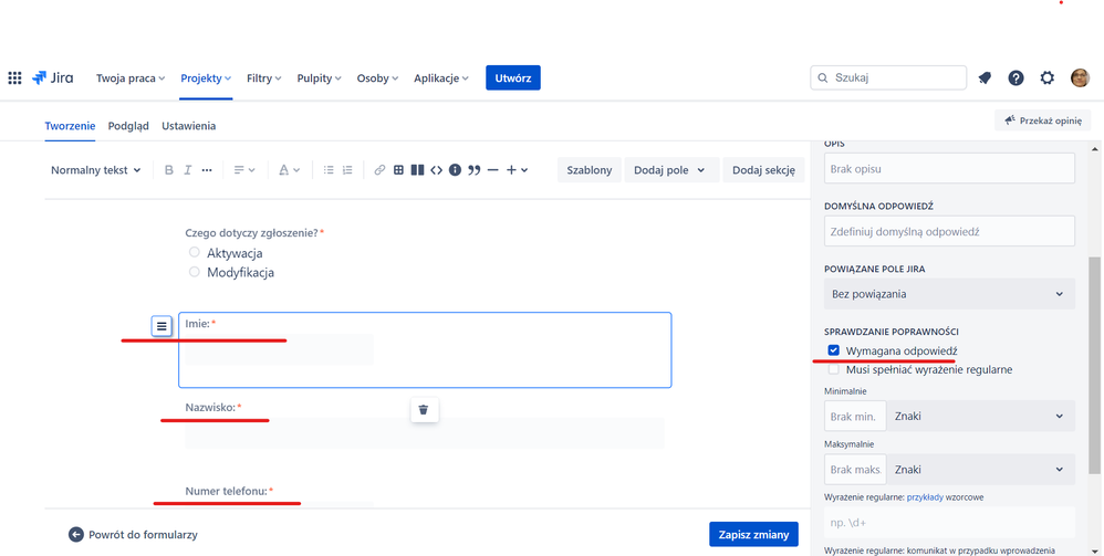

This is the view of the forms (edit):
It is in polish.

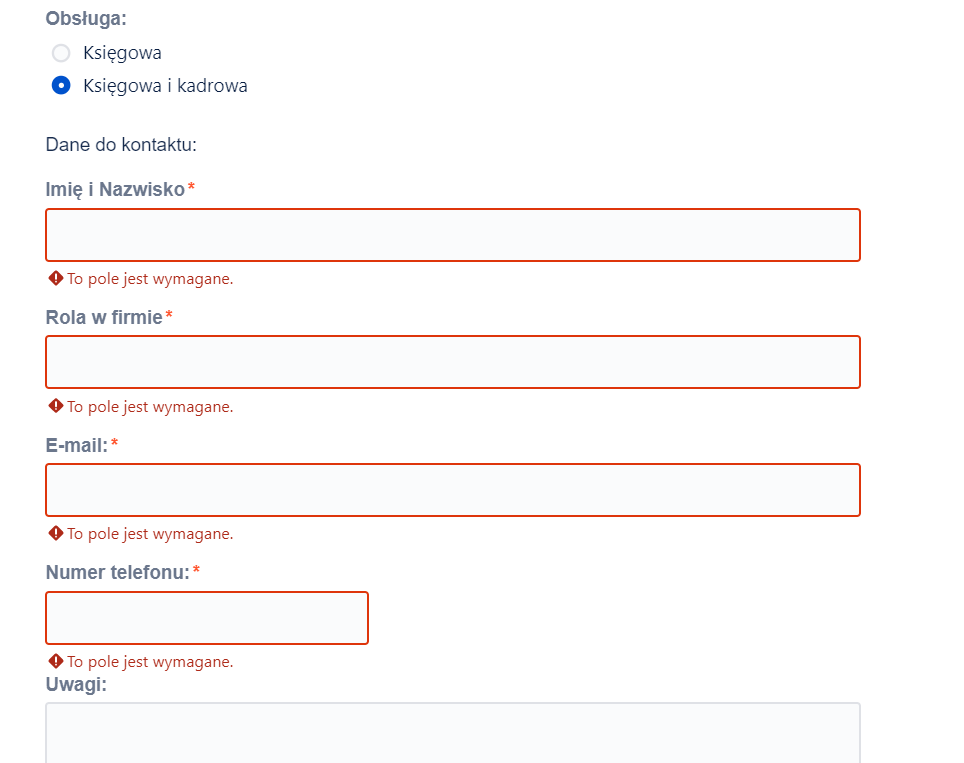

When I press create button, in portal on service request, only for summary field I see "Please enter the right value for the field", as you can see Imie, Nazwisko were not validated.
But for incydent looks ok:

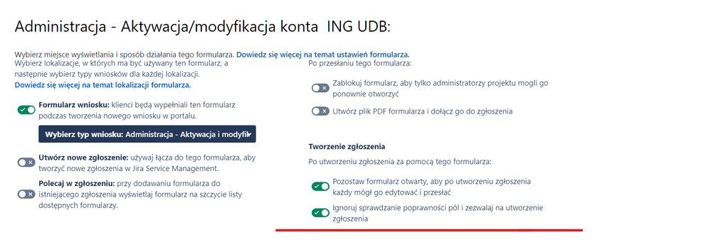

Anna Arczynska
January 2, 2023
I shoot myself in the foot. I'm so embarrassed :D
sorry for that:
It was marked for some forms by mistake ehh.
Like Jack Brickey likes this
Jack Brickey
January 2, 2023
Hey it happens! Glad you found it.
