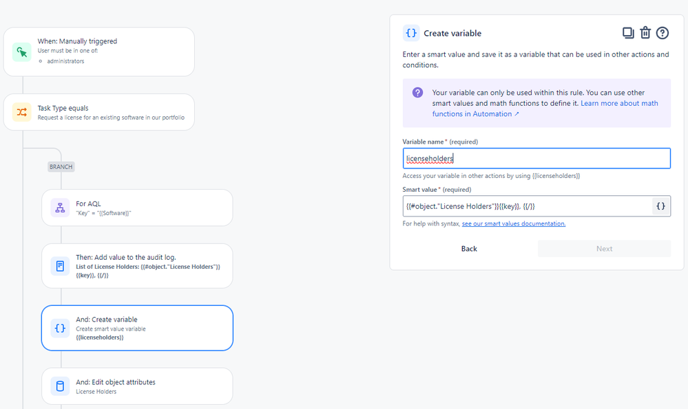

Step 1: Add the value chosen in the Assignee Insight Custom field to the chosen Software's Assignees attribute (this needs to append to the existing attribute value so we can list all Users with a license for Software X)
I feel I was getting close to a solution but I had an issue with the final step of editing the assets attribute and was getting the error "Attribute value is not valid on Objects".
As a Global Automation rule:
  1. Trigger on transition to Done
  2. Condition on the issue type
  3. Branch on AQL - "Key" = "{{Software}}"
  4. I did a log action to ensure I was pulling all the user keys in the object attribute with my smart value.
  5. Create Variable called {{licenseholders}} with the same smart value {{#object."License Holders"}}{{key}}, {{/}}
  6. Edit Object, edit the License Holders attribute with the variable created above plus the new license holder with the following smart value: {{licenseholders}}{{issue.customfield_#####.Key}} - in this case the customfield was my User asset field.
As I said this doesn't work, the smart values aren't accepted as valid attribute values however it did show in the log the list of object keys including the new user value from the current issue.

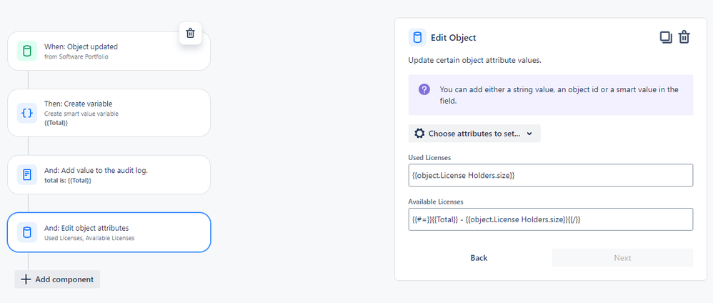

Step 2: Calculate the number of used and available licenses by Total License Count - Assignees size.
I did find an solution for calculating the number of used and available licenses.
  1. Trigger when Object Updated
  2. Create variable name {{Total}} from the smart value {{object.Total License count}} - this is a static number field containing the total number of licenses.
  3. Added a log action to confirm the number is pulling correctly.
  4. Edit the Object Attributes:
    1. Used Licenses: {{object.License Holders.size}} - this counts the number of user objects in the license holder attribute
    2. Available Licenses: {{#=}}{{Total}} - {{object.License Holders.size}}{{/}} - calculates the difference between the total and the used license size.
Unfortunately, that's as far as I got, without Step 1 there was little point in investing time into any automations for unassigning.
