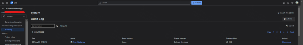

 HI @Nikola Perisic @Kevin Vancrutsen
 Additionally, you can add yourself to the notification scheme when a task is deletedСнимок экрана 2025-08-29 131628.png

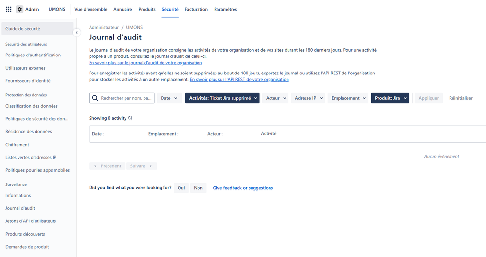

@Nikola Perisic 1. is it normal the audit log is empty ?
Amir Atadjanov
August 29, 2025
Audit log in Jira
Nikola Perisic
August 29, 2025
@Kevin Vancrutsen
Have you searched for that agent with their email address?
