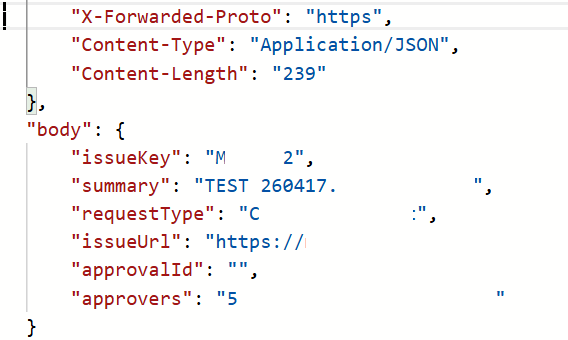

I did check out those pages, which got me closer, but still missing the "approvalId" smart value.
In the target app that is looking for the updated webhook, it sees the following data in the webhook (redacted for security.)  We can see that every other variable in the webhook has correct data. Except for the "approvalId" spot, which is an empty string.
As if I might not have the smart value right in the 1st place.
This also verifies that the webhook data content-type is JSON (had to manually type that into the additional info of the JSM automation).

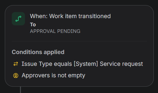

Hi Bill, I can share what the automation trigger looks like.
But even on that page You shared, it doesn't mention {approval.id} unless the Approval ID is one of these other smart values?
To clarify, when the ticket status is set to [APPROVAL PENDING], and those conditions are applied, POST that data in the webhook. The other variables are successfully filled in except "approvalId".
