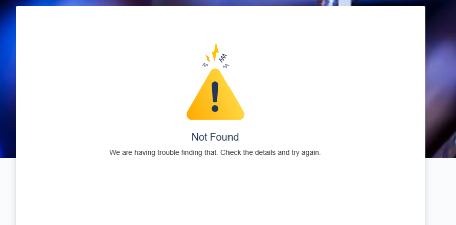

It works as a confluence user, but when a customer logs in to service desk, the link is broken with:
Not Found
We are having trouble finding that. Check the details and try again.
I can link to the page itself, just not to an anchor or heading.

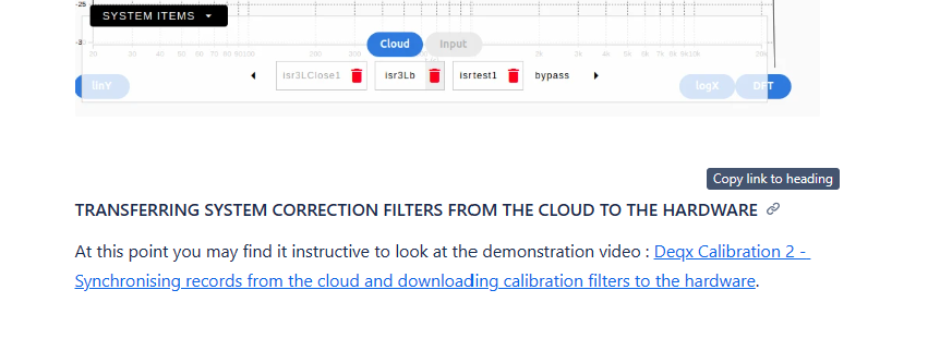

Steps to reproduce.
  1. Go to destination article.
  2. Find the heading and click on the copy link button that comes up on the right side of the headingScreenshot 2024-03-18 124449.png
  3. Go to the source article.
  4. Paste the link in the source article.
  5. Update the page.
  6. Now if you are logged in as a confluence user, clicking on the link in the source article takes you to the destination page and heading.
  7. If you are logged in as a service desk customer that has permissions to view the pages, the link does NOT work

  8. This is the error that comes up.

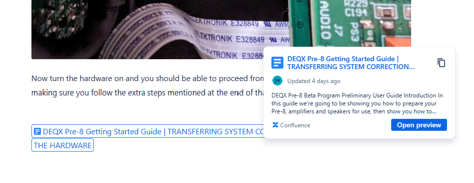

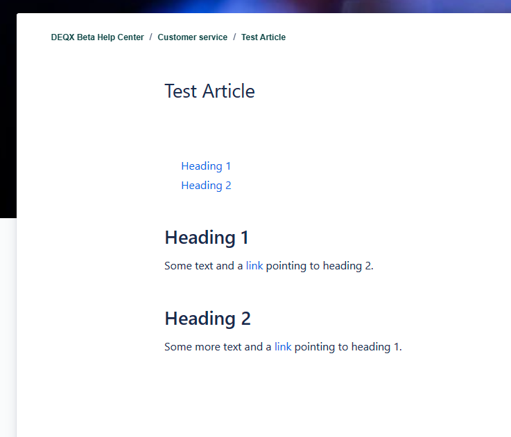

I've just reproduced it on a single page:
So, if you click on heading 1 or or 2 at the top, nothing happens (it can't scroll anywhere as both headings are within view) ...
But if I click on either link in the text, which I've just copied the links from the Headings above... it opens a new tab and asks my customer to log into confluence with an Atlassian account!
I'm happy to give customer access to anyone who might have an idea and wants to check it ... I can't make the confluence space or knowledge base public, as I'm assuming it will work ok if I do that, but it's not a public knowledge base....
Any other suggestions will be greatly appreciated, not sure what else I can do... I have had to literally remove all internal links in my documents, as I've had customers click on them and get prompted to create an Atlassian account!
Thanks in advance for any and all help - I'm very confused as to what I could be doing wrong!

@Joseph Narai Thanks for the follow-up.  I was able to recreate the issue that you are having based on what you shared above.  There is a simple fix.  When you add the link is all you have to add is the end of the URL, the # piece.  This is all that is needed to access the link on the page.
Example:
Link that you copied: https://XXXXXXXXX.atlassian.net/wiki/spaces/XXXX/pages/XXXXXXXXXX/Link+Test+2#This-is-header-3
What you should add to from the link so it will work in the KB: #This-is-header-3

@Joseph Narai I was able to do a little testing and when cross-linking pages I was never able to run into any issue if I used the link button in the Confluence editor.  If I copied the URL from the URL or Link and I added it to a page using this button it always worked in the JSM portal.   All of those links on one page properly loaded to the other page within JSM.  I was also able to hover over the links and see that it is correct as well.  For instance if I had the following link in Confluence and it showed as such in Confluence the actual link was different in JSM even though it link text showed what it was in Confluence.
Confluence Link - https://XXXXXX.atlassian.net/wiki/spaces/XXXXXXXX/pages/XXXXXXXXXX/Link+Test+2#This-is-header-3
JSM Link on Hover or Click - https://XXXXX.atlassian.net/plugins/servlet/servicedesk/customer/confluence/shim/spaces/XXXXX/pages/XXXXXXXXXX/Link+Test+2#This-is-header-3
