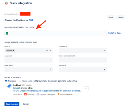

Can you please confirm if you are using a third-party app to integrate Jira with Slack or are you using the official Jira Cloud for Slack app?
If you are using the official APP, you can set a filter to define which notifications you want to receive in your Slack channels. You just need to click on the option "Switch to JQL" on the integration page and a bar will be displayed where you can use a JQL syntax to select specific Issue(s) that will trigger the notification:

This could be an option, but two things:
  1. I'm unsure what we would filter on. Maybe a Slack channel ID? But, I'm not sure we can write that over to the Jira ticket automatically upon creation.
  2. We would have to setup this filter manually every time we created a new client channel, which isn't ideal.
Would love to hear your thoughts.

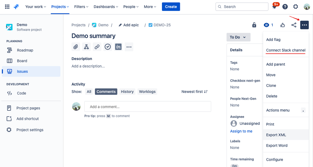

1. You can link a specific issue to a channel from the issue page:

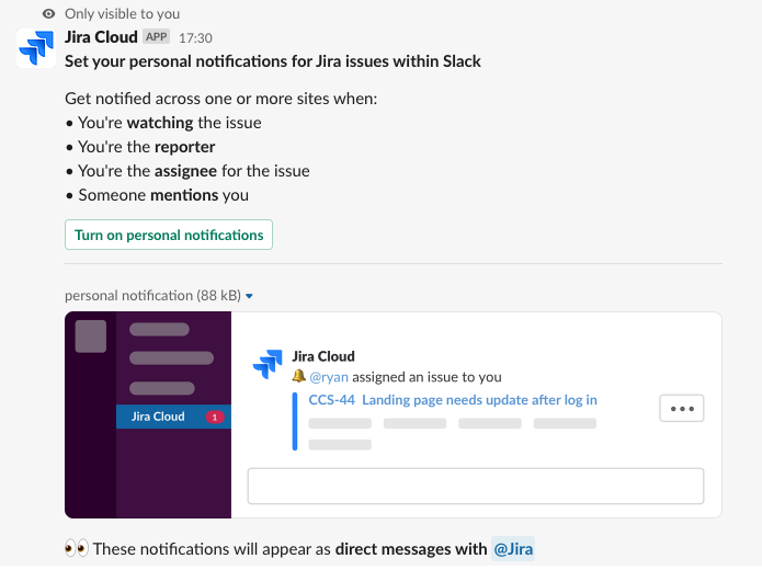

2. Another option is to set up personal notifications. In this way, you would receive only updates about issues you created, watching or if you are mentioned in the issue. To set up those, type /jira notify in any channel and this will set up personal notifications for you.
