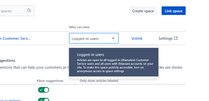

When looking at a free plan instance I can see two options
  • Only confluence users
  • Logged in users

I've switched back to FREE and now I only get this option under "who can view"
I don't have the "only confluence users" at all.

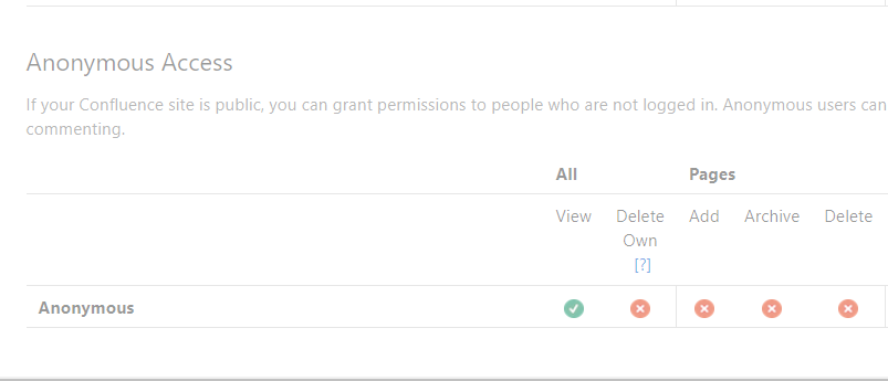

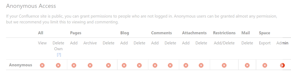

If I look back at the permissions for the Confluence Space that is my Knowledge Base, the Anonymous view is still set to view - which explains that behaviour, but I thought this would be reset back to disallowed when moving back to the FREE plan.
I suspect that something will reset this and I'll be back to where I was before too long...

hmm I have the same setting in a free service management instance e.g. logged in users

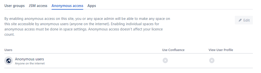

and have anon access as disabled for all permissions (also unable to change these permissions due to this being free tier)

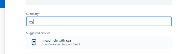

however if I log in with a customer account to the service desk portal and start an issue summary with something that matches a page in the confluence space I see suggested articles:

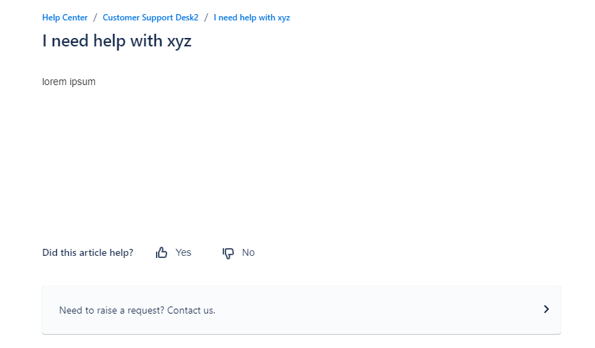

and am able to click on the article that takes me to the article:

I think I'm in the current state because I was able to enable Anonymous View access when I went onto the Standard plan trial, and now I've moved back to Free it hasn't reverted back to "not allowed" (yet?!)

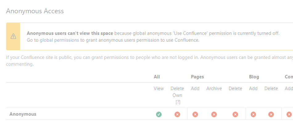

Overnight, this warning has appeared:
And - as anticipated - no more public access.
The Global Permission is unset and cannot be changed in the Free plan
Knowledge base "who can view" is set to "Logged-in users" as before.
BUT... drum roll... I have a test user logged in and it now CAN see the knowledge base articles!
I don't know what was wrong before, but hopefully this will stick - I'll keep checking :)
