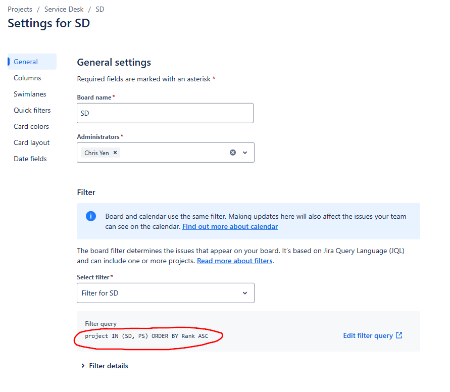

Hi @Michael Ruhdorfer
My mistake I forgot the views feature was added to JSM. I enabled it in my sandbox and it looks like it's the same setup as boards in Jira Software so the instructions are the same, top right of your kanban board click the three dots, then click configure board, and you can update the board filter query to look at multiple projects
2025-04-01 22_35_17-Service Desk - Views Settings - Service project - Jira.png
