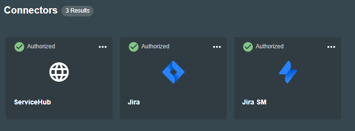

Florin
February 13, 2024
Hi @Bobby Bailey
I think I found some documentation for ServiceHub:
https://github.com/timicoltd/ServiceHub-Developer
I am testing the app.
Connectors:
And this is the workspace:
I am still getting the hang of it, I don't have much scripting knowledge. And now I am trying to figure out how to send and receive the required information.
Thank you,
Florin
