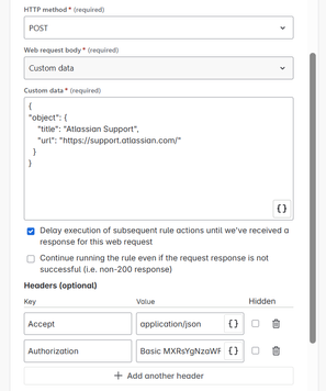

If your need (and subsequent readers) is the same as mine, I just automated it by making an API call ("Send web request" in Automation) to Create or update remote issue link: https://developer.atlassian.com/cloud/jira/platform/rest/v3/api-group-issue-remote-links/#api-rest-api-3-issue-issueidorkey-remotelink-post
Slava Gefen
June 16, 2025
It worked, thank you!
Just in case for someone who wants to achieve the same:
With kind regards
Slava

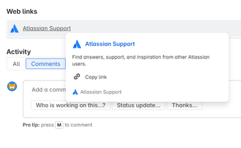

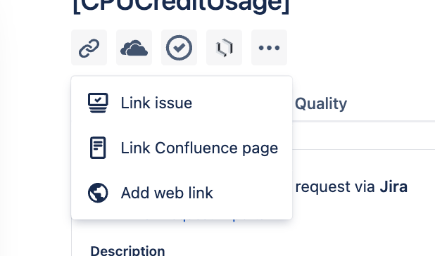

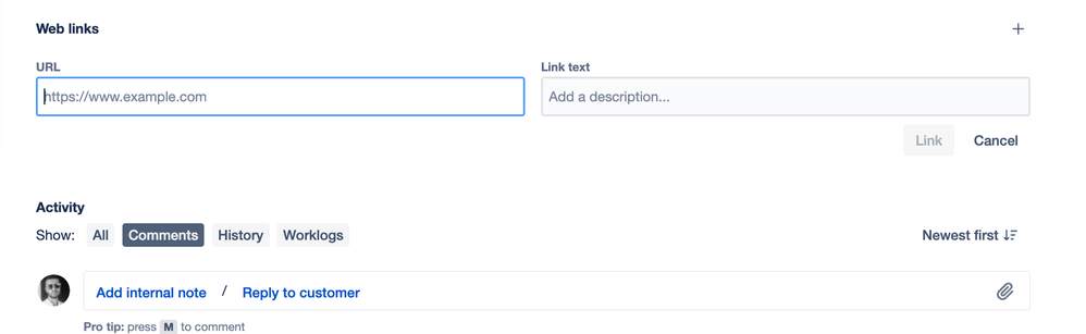

Kindly check the screenshots which I will attach for reference below.
I would like to make an automation to add web links in every auto generated ticket to my project.
