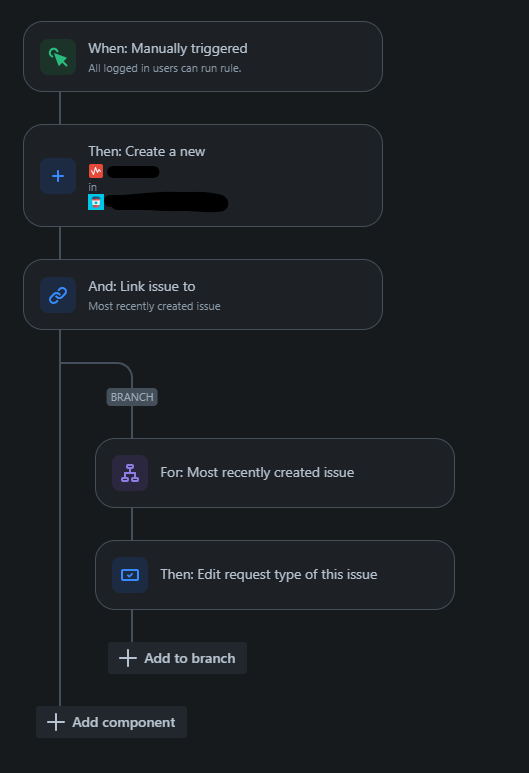

Exactly what I needed. Looks like the "Create Issue with request type" didn't like all the custom fields we were passing, but the branch "most recently created issue" worked fine. For anyone finding this in the future: make sure the scope includes both service boards and here's the rule layout (the link issue just links the created issue to the original):

So when I switched it to "Create Issue with request type", my the JSON that was working before stopped copying the values. I had to use the branch described here with an "Edit issue fields" action:
- Add Components from Trigger issue
- json as (it only worked with a variable):
