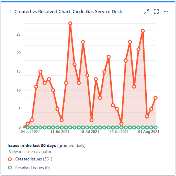

when you say the "resolved tools is broken" - and assuming you mean there are no values displayed. Are you sure there is a resolution set on those issues?

The relevant criteria, I agree to Jack, is the resolution - probably it is not set in your issues.
Please check if the resolution will be set correctly for the green line of resolved issues to behave correctly.

I tried the dashboard and was able to setup the created vs resolved gadget but unfortunately it wasn't of much help as the resolved tools is broken. It reads zero on every setup.
Jack Brickey
July 18, 2021
If it displays zero then the filter you are using is the reason. Ensure your filter is accurately capturing the issues you want.

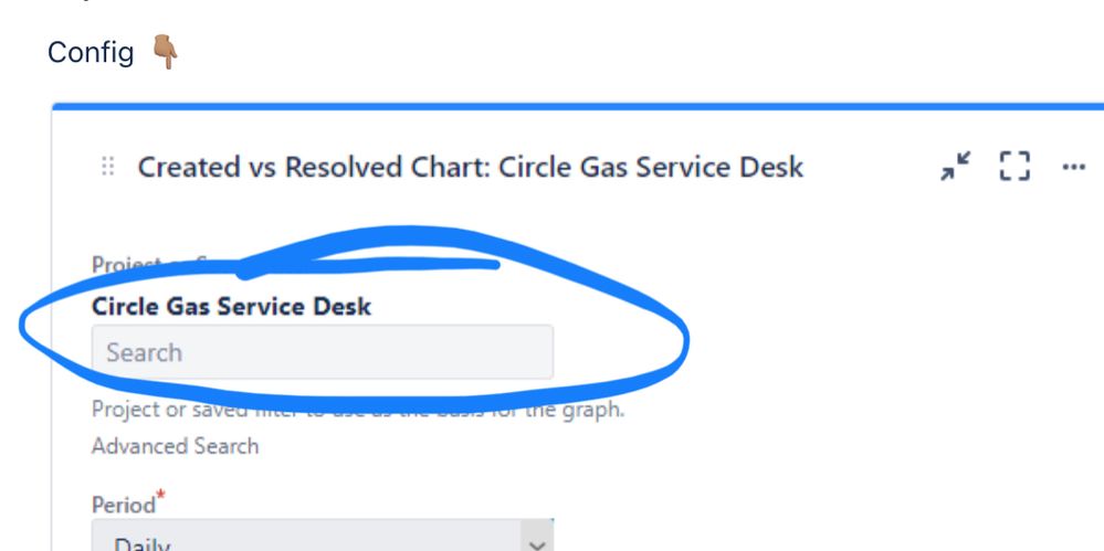

Please find the below screenshot. There is not much of filter control I have. It is an automated filter.
Any other recommendations.
Config 👇🏽
Results👇🏽
Jack Brickey
August 2, 2021
In your first screen shot the first entry is where you can enter the desired filter. It appears the current filter is using the project. You could create a filter under the advanced search, save it and the associate within your gadget. Now regarding you green line showing zero, I suspect you ar3 not setting the Resolution field when moving issues to your done status(es).
