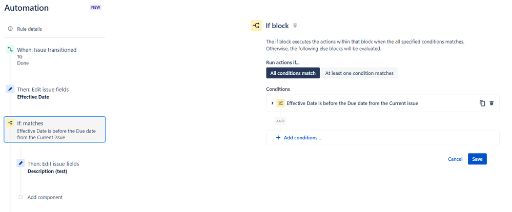

This is how I would go about setting this up:

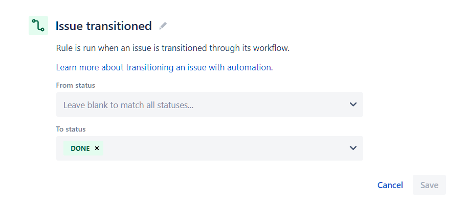

  1. We will check if the date fields are met when the ticket is completed. For this, we will set up an automation that is run, when a ticket is closed.

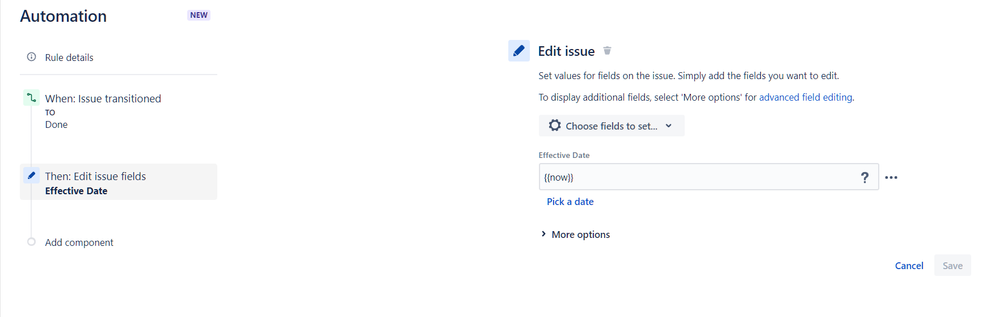

  2. We will update the "actual completion date" (Effective Date in my case) with a smart value of {{now}}. We do this so that we can then compare this with the "Planned Completion Date"

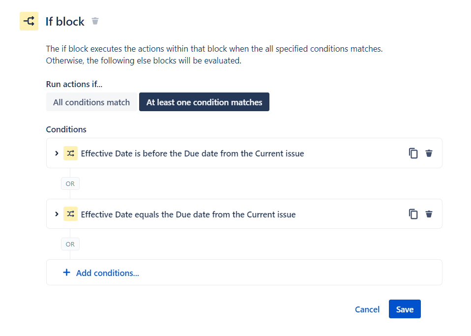

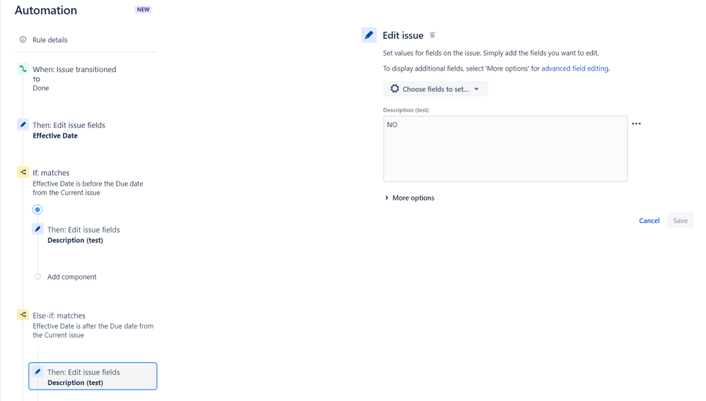

  3. Create two "if blocks" where you set up one to check that the "Planned Completion Date" (Effective Date in my example) is before the "Actual Completion Date" (Due Date in my example) and one to check if the "Planned Completion Date" is after the "Actual Completion Date"
  4. Under each "if block" add an edit that changes the "SLA Met" (Description test in my example) depending on the condition
Let me know if this works for you or if you need any help.
Since there is no "<=" you can set up the check to be as follows:

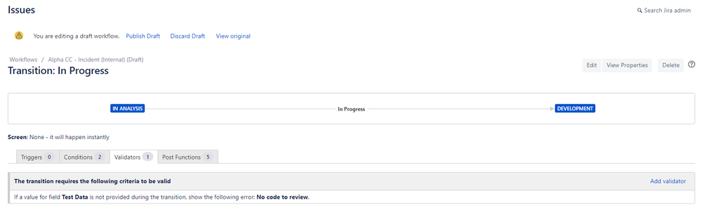

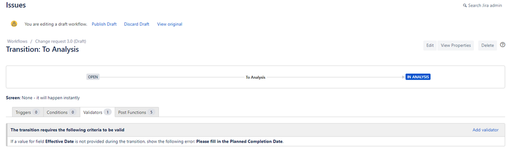

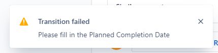

If you want the field to be "mandatory" you can add a validation in the Workflow.
  • Go to project settings -> Workflows
  • Edit the Workflows that you would like to have the validation
    1. Select a transition you would like to check if the field is updated
    2. Add a check for "Field required for this transition" (You can also choose a message to display)
Note that this verification will need to be placed in the workflow so that the operator cannot simply close the ticket.
Example:
  1. You add this for Open -> Analysis
  2. The operator uses the Open -> Done ( Done has the "Allow all statuses to transition to this one" in this example)
