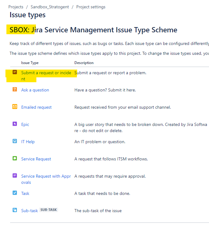

Mohammed Yaseen
January 16, 2024
Hi @Eugenio Onofre
Thanks for the response.
I'm using "Submit a request or incident" issue type in logicmonitor and it's already present in the issue type scheme in the project but still facing the issue.
Eugenio Onofre
January 17, 2024
Hi @Mohammed Yaseen
The configuration on Jira side seems to be working fine.
I would suggest two next steps:
  1. Try to create a ticket in your project by using Jira Issue API (this seems to be the one being used by LogicMonitor integration). If the creation works, it means there is an issue on LogicMonitor integration. In case it does not, it means the issue is on Jira side.
  2. Get in touch with LogicMonitor support so they can better assist you as the configuration in Jira seems correct.
