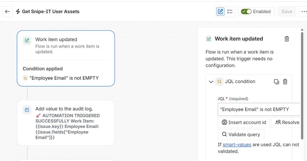

At this point, I'm just trying to get the form to trigger and write to the Audit Log
The Audit Log never gets an entry.
1.) can I trigger an automation when I open the form after it was created, so basically edit the form.  Check to make sure there is an email in the field Employee Email.  If so, write to the Audit Log.
Once I can trigger the automation, I will work on actually doing what I want which is run an GET REST API call to Snipe-IT and retrieve the users (Employee Email) assets that have been assigned.

Whenever you ask for help with an Automation Rule it will help us to help you if you provide:
1. what type of project is this (e.g., company-managed, team-managed, etc.),
2. images that show your complete rule.
3. images showing the details of any relevant actions/conditions/branches.
4. images showing the Audit Log details for the rule execution.
5. Explain where the issue is.
These questions are not for not willing to help, but to have community members understand on how automation works.

Hi @Terry Middleton
First remove the condition from the trigger, they are known to fail due to timing issues.
Add the condition as a separate action in the rule, to check if all works add a log action to see if field Employee Email has a value, use smart values {{issue.Employee Email}}
