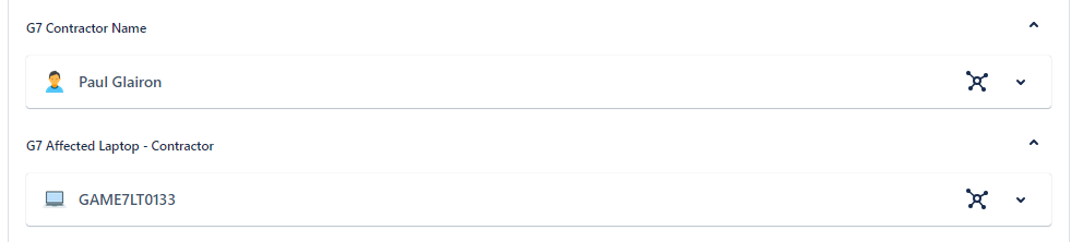

I put these in and tested it. It pulled the Device name but none of the other information. I have more screenshots for you in case that helps. Also, the contractor is linked to the ticket as well so I was trying to pull their name from that field instead of owner of the device. Not sure which way is easier.
This screenshot is from the ticket (issue) where you can see both the contractor that is assigned and the affected laptop field with the device name, which is what the email did successfully populate with.
I was able to pull the contractors name from the ticket successfully into the email with
{{issue.G7 Contractor Name.label}}

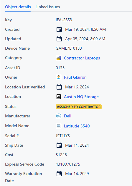

This is what I see if I select the affected laptop object from the ticket so that you can see the additional fields I'm trying to pull the data from.

I see now that Model Name is referencing another object so that would change to something like this:
{{issue.G7 Affected Laptop - Contractor.Model Name.label}}
Not being able to pull in Cost is puzzling. Perhaps case sensitivity is in play. In my original answer, I kept it lower case but I see the attribute is upper case. It shouldn't be case sensitive, but just in case, let's try:
{{issue.G7 Affected Laptop - Contractor.Cost}}
