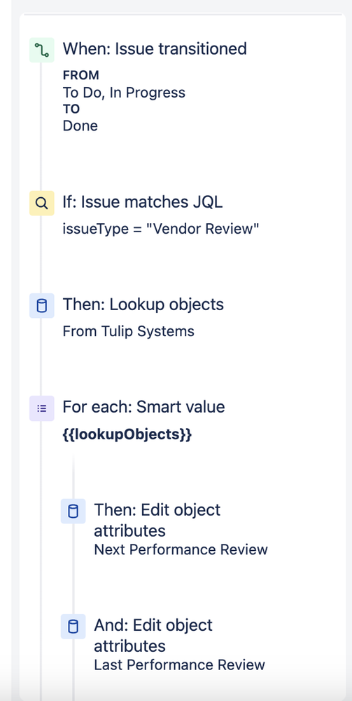

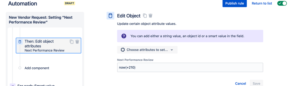

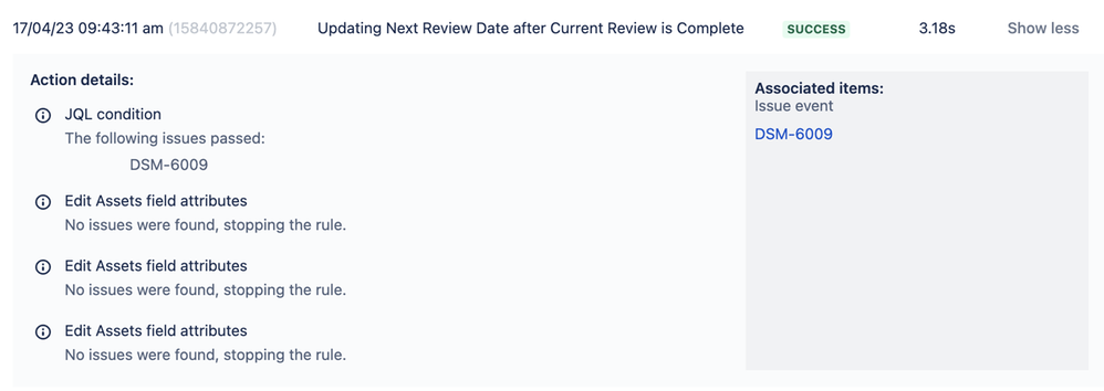

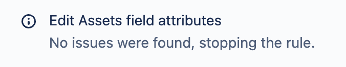

I am currently working on an automation rule that edits object attributes.  After I perform the object lookup I perform the action and its at this point where I am running into issues. You can see the action below which is is an "Edit object attributes" action and this edits the "Next Performance Review Date". And when I run the rule it runs successfully, but only because it outputs the following message "Edit Assets field attributes, No issues were found, stopping the rule". The message is incorrectly outputting that I am running an "Edit Assets field attributes" action when in reality I am running an "Edit object attributes" action.
Additionally, the error message state that "no issues were found", which is confusing because no issues are being edited/updated as a result of this action, only the object that has been looked up should be updated. I'm not sure if this is a bug or if there is a work around, but I'm looking to see if others have had similar issues and how they've worked around this.
Action being performed:
Message in audit log:

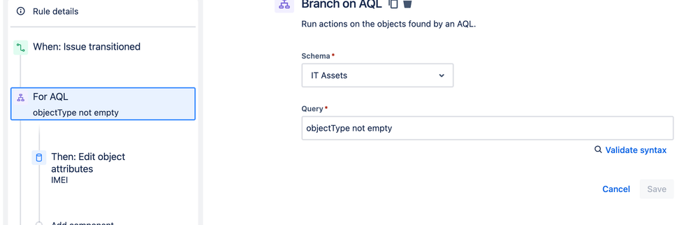

Pier-Olivier Tremblay
April 17, 2023
you need to use the AQL Branch if you want to edit the objects.
Branching on a smartvalue will only let you read!
Haig Aboyan
May 8, 2023
I also realized that I dont want to update the "Next Performance Review Date" via "now(+180d)" because that updates the attribute to a 18p days from today. I want to add a 180 days to the currently stored date. Any suggestions on how to achieve this?

Hi @Haig Aboyan
could you post a screenshot of the whole rule?
Haig Aboyan
April 17, 2023
Hi @Kai Becker
Screenshot 2023-04-17 at 9.44.33 AM.pngScreenshot 2023-04-17 at 9.44.42 AM.png

Kai Becker
May 24, 2023
@Nathan Allen@Haig Aboyan  you need to branch on AQL, otherwise the rule will focus on the issues instead of the objects. Please put the AQL from lookup objects into the branching part.
Here is a simple example:
Nathan Allen
May 25, 2023
@Kai Becker I don't have any option to branch on AQL, not sure where you're finding that.
May 25, 2023
The rule needs to be global to make it appear !
Like # people like this
Nathan Allen
May 25, 2023
Perfect. Thanks!

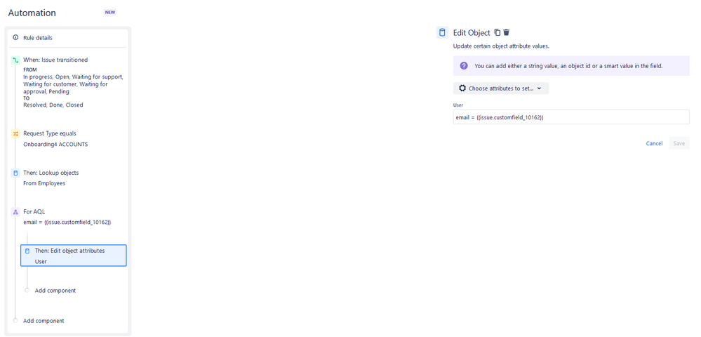

nicolae.cotan
November 21, 2023
Hello, i need the same use but for users. I need to edit and object attribute called User and fill it with the atlassian user.

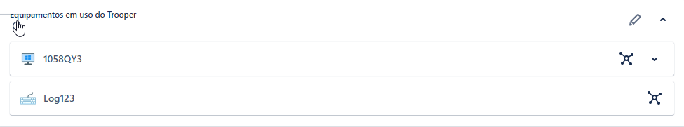

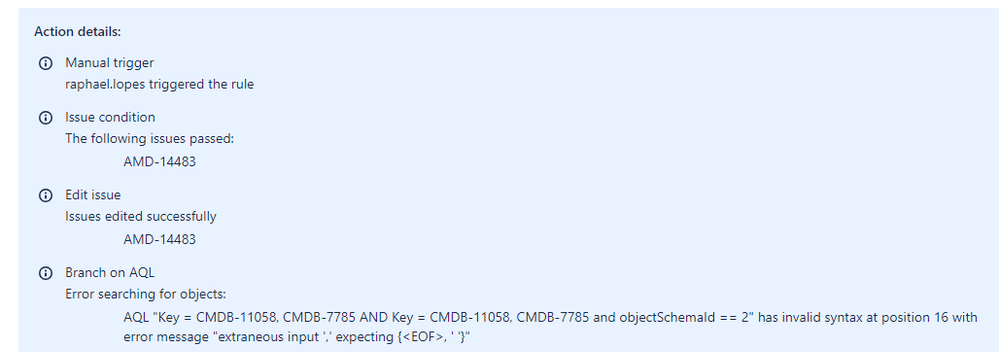

raphael_lopes
November 23, 2023
how to edit attribute with atomation when a filed have more than a object?
Like César Koffi likes this
raphael_lopes
November 23, 2023

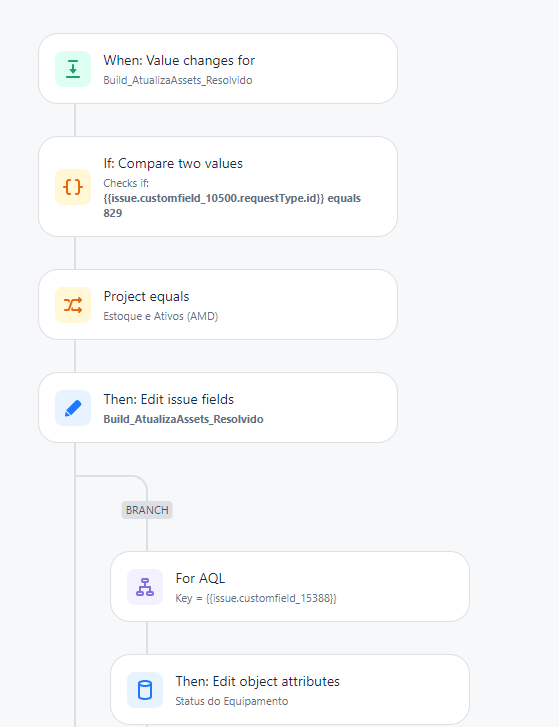

Sidney Dizon
April 9, 2024
@raphael_lopes were you able to find an answer to that?
I am having the same problem
raphael_lopes
June 12, 2024
Yes, I did, my automation looks like this.
Like Stefan Michael Kreidl likes this
