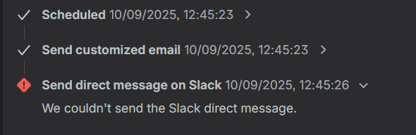

Hello,
I have a problem with Jira Global Automation (Service management), whenever i try to do a rule, that sends the direct message to a person on a slack, it cannot be done.
I've synchronized both platforms, via Chat and video tools, or Slack integration itself. Everything else is running. Rule works, validates and it sends emails, but it cannot send DM on slack.
On slack: Jira Cloud, Jira, Jira ChatOps and Assist apps are implemented, it works pretty well. The permissions are also assigned, to write, to map the users between platforms, to see all the users at slack, to create a new DM.
Every synch setting is turned on and linked with the Slack Workspace.
What i have found, is the solution with webhooks, but i heard somewhere that webhooks are about to be turned off soon, so i prefer to use newer synch method.
Maybe you guys have any ideas on how to fix this issue...
I'am also open for a new suggestions on how to make the rule run notifications on Slack.
Best regards

Hi @Jakub Filo,

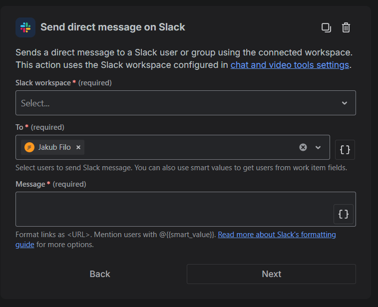

When you are sending the DM, are you using the user's Slack Member Id?

I probably can't use the member ID in this form, so I'm using email addresses, which are the same in both Jira and Slack. Then it shows me as in the picture below. Maybe I'm doing something wrong, or I'm using wrong form 🥲

Mikael Sandberg
October 9, 2025
I just tested and it looks like the new Send direct message on Slack isn't working correctly. I would suggest that you contact Atlassian support and have them look into it.
My test automation was able to send a message using the Send Slack message component, and if you use that one you can send DMs as long as you know the user's Slack member Id.
