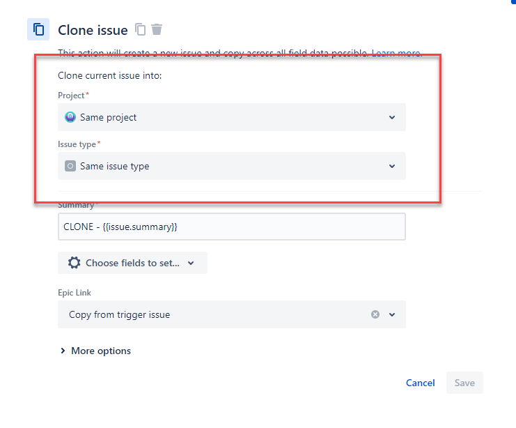

In our project, I have an epic set up with tasks that i want to replicate every time a similar epic is created. I have a rule that is triggered by an Epic that looks to the list of these tasks and clones them. My problem is that I can't get the new cloned issues to be associated to the trigger Epic. Since the trigger is the Epic, when I select the Fields to Set ... Epic Link --> "Copy from Trigger Issue" - I get the error
No fields or field values to edit for issues (could be due to some field values not existing in a given project)
Not sure what else I am missing here.
Here is the clone action

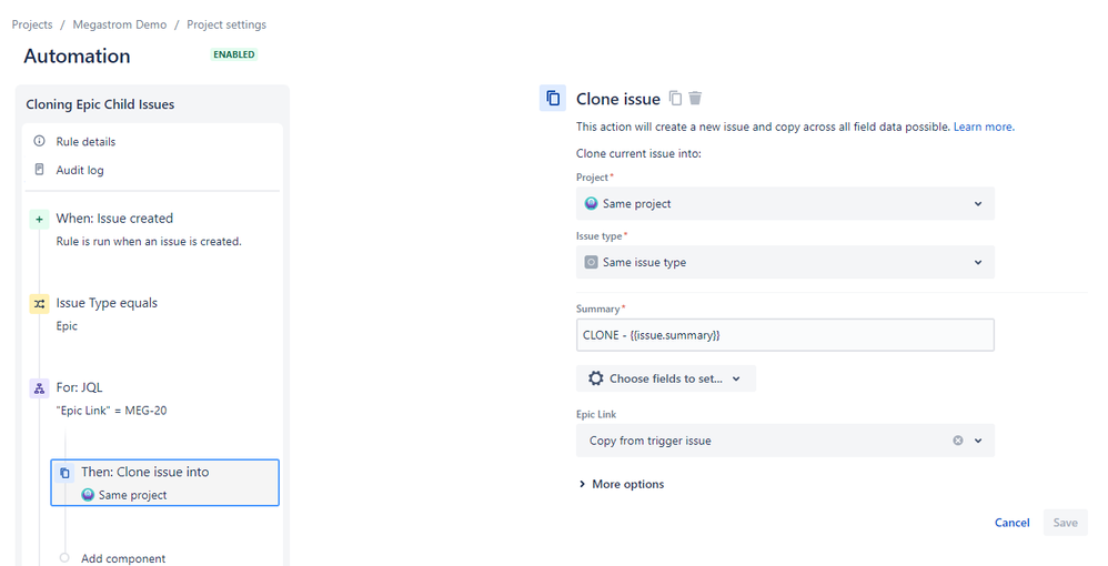

Thanks for the update.  I just setup a test automation rule (similar to what you provided), and everything works just fine
You may want to remove your custodian field out from rule - essentially just setup your rule to clone the children of FEEDS-10089 Epic (simplify the rule to just copy the issue summary and add the Epic link relationship to the newly created Epic) to ensure the cloning works and roll-up works.  Afterward, adding additional fields to the rule and re test again.

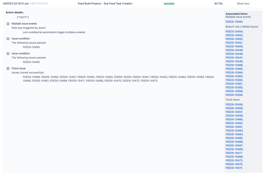

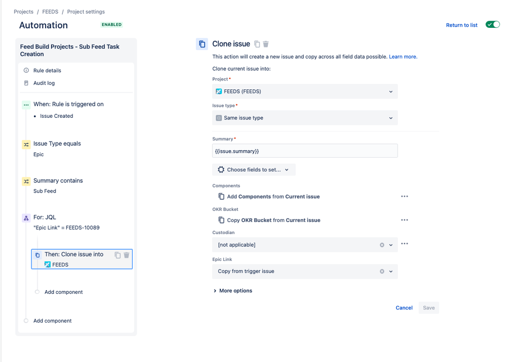

I've removed all of the "Fields to set records" except the Epic Link Relationship but it still added the new tasks under the Feeds-10089 epic rather than under the trigger epic
Rule and audit log attached
Screenshot 2023-07-14 at 2.22.21 PM.pngScreenshot 2023-07-14 at 2.32.40 PM.png
I also thought and tried to run this by adding a subsequent step and creating the link after the issues were cloned, but there I can't make the issues "child" issues of the target Epic, but can only create a linked  relationship - sub task of target issue - which is not what I am looking to do.  :(

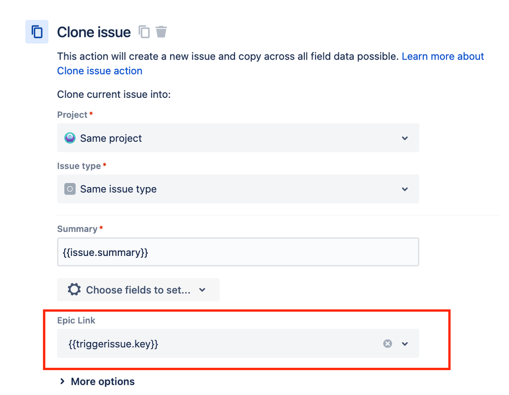

Wanted to come back here and provide the solution that finally worked:
Epic Link value in the Clone Issue Seciton as {{triggerissue.key}}
