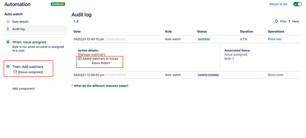

Hi @Alex Koxaras -Relational- ,
I've just tried it on my test isntance and it looks like it works fine with {{issue.assignee}} as you can see :
I'm not sure if you're describing the same scenario : are you also using the Automation Rule to set the Assignee ?
Let me know if this helps,
--Alexis

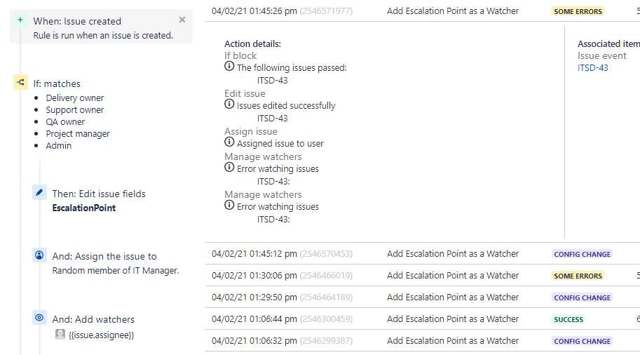

February 4, 2021
Hi Alexis!
Thank you for your swift reply. Unfortunately, mine doesn't work. As you can see, I assign the user in the prior step before adding him as a watcher. I can confirm that whenever I create a ticket the first IF statement is activated.
My user has all roles assigned to him within the project (in this instance as an IT manager) and has all the necessary permission to be assigned to the project (I'm eligible to assign him the issue from the "reporter" account id).

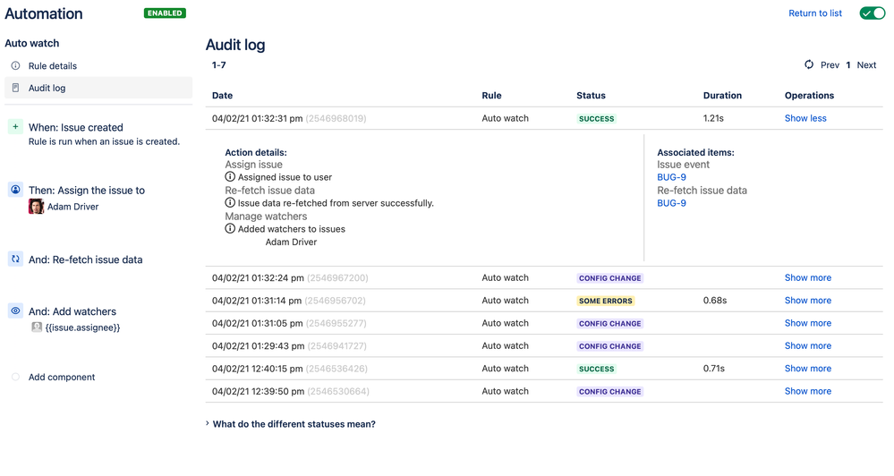

Alexis Robert
February 4, 2021
I have tried again and you're right : it won't work if you have an action to Assign the issue and then use that value for the watcher.
I've how to fix this : you need to add "Re-fetch issue data" between the "Assign" and "Add watcher" steps :
This way works for me at least.
Thanks,
--Alexis
