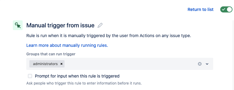

Hi @Dewa Fakha Shiva
For manual trigger, you can use this trigger "Manual trigger from issue". This trigger allows the rule is run when it is manually triggered by the user from Actions on any issue type.

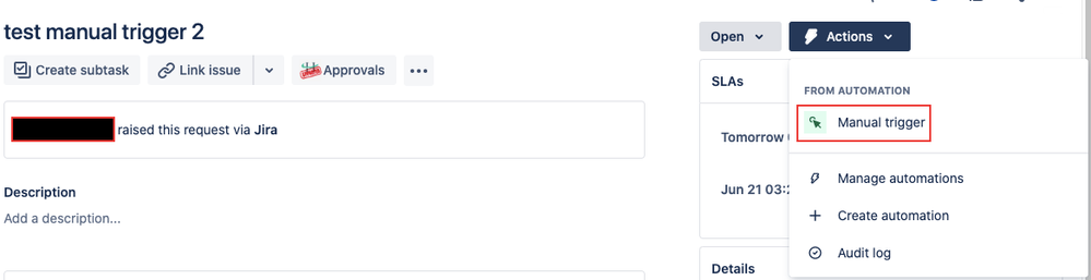

On the issue screen, you can click on the button "Manual trigger" in Action field to start the automation.Ảnh chuĢ£p MaĢ€n hiĢ€nh 2023-06-07 lúc 15.35.14.png

Hi Nhat,
I have setup the way to did, but nothing works, but then I checked if my user is part of the admin group, and turns out I'm not in the admin group.
After I add my user to admin group, everything works fine.
Thank you for your help.
