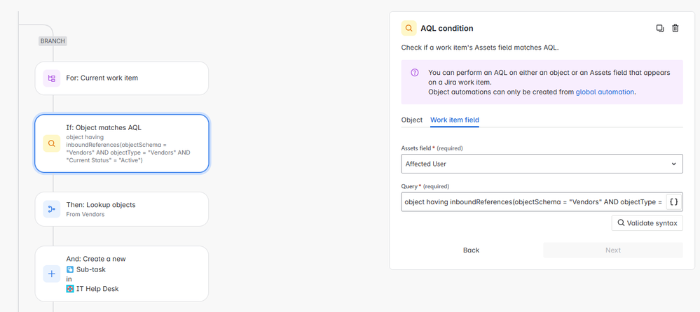

I am trying to update our decommission user automation to look up asset objects where the user being decommissioned is referenced, then adding the name of the asset they are being referenced in a subtask. On the issue, the Affected user custom field is updated with the user being decommissioned (linked to Employee_Data objects in Assets). The rule will check if the Affected User is listed in certain attributes in assets, then create a subtask. If it doesn't exist, the subtask is not created.

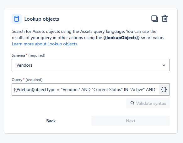

{{#debug}}objectType = "Vendors" AND "Current Status" IN "Active" AND "Relationship Manager" IN "{{issue.Affected User.Name}}"{{/}}
I am getting an "Assets field condition failed" error in the AQL Condition. I am not sure what I am doing wrong and have tried many different AQL queries. Any insight or recommendations pointing me in the right direction would be greatly appreciated.

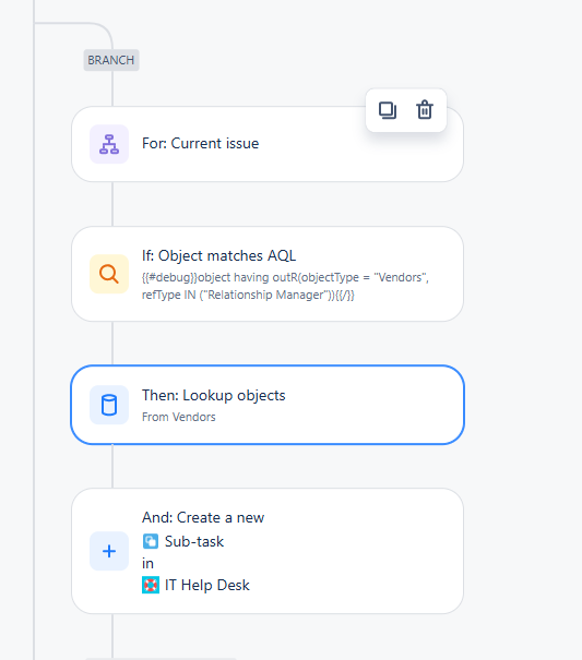

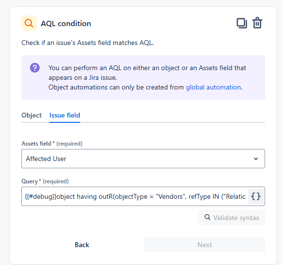

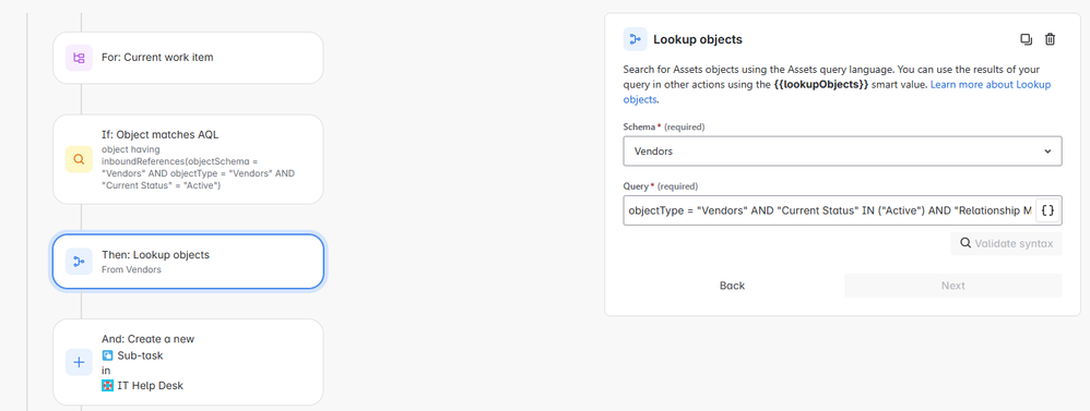

I was able to figure this out. The issue was that my Assets Field I was using was querying another schema, which can't be done.
Instead I queried the inbound references on my Asset Field, then did a lookup object action to look up the objects that were referenced in the previous action.Screenshot 2025-05-22 154119.pngScreenshot 2025-05-22 154604.png

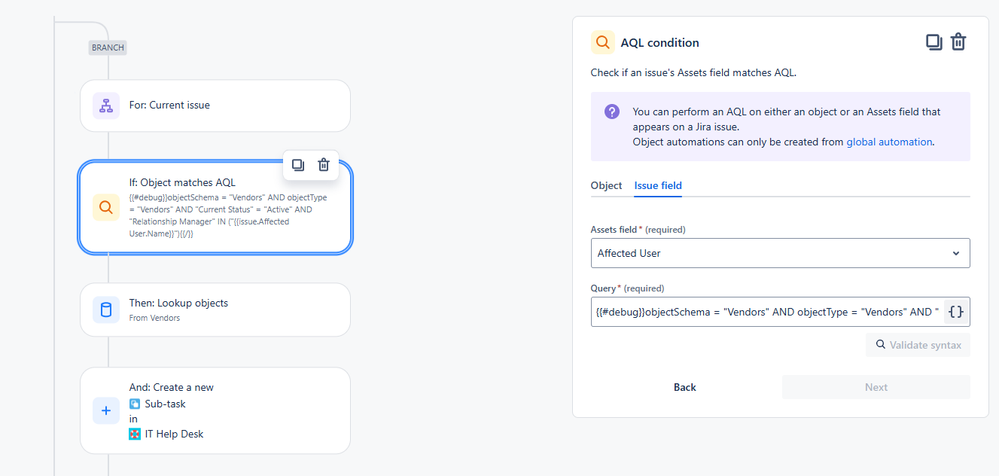

I believe there should be parentheses surrounding the values when using the IN operator:
{{#debug}}objectType = "Vendors" AND "Current Status" IN ("Active") AND "Relationship Manager" IN ("{{issue.Affected User.Name}}"){{/}}

Hi @Bill Sheboy
Thank you for the response. Adding in the parentheses unfortunately did not produce any results.

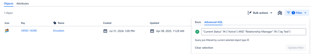

I try the Advanced AQL editor in Assets with and with out the parentheses and still would produce the results I expect, but for some reason is not working in the automation rule.

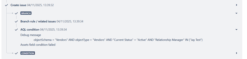

If you expand the branch area in the audit log to look at the issue keys, is the one you show with that standalone AQL query the same for the specific Affected User field: VEND-14390?  Or did it not match for the specific issue the rule branched over?
Andy Thelen
April 11, 2025
From the audit log screenshot I posted before, the branch rule was fully expanded so I can't see the keys. The branch trigger is set for the current issue, which is where the Affected User field is set. It looks like the condition did not find the match, but it should find VEND-14390.
Some information I left out was that each object type is in a different schema. Affected User is in the Accounts Schema (Employee_Data Object Type), while the Vendor Object Type is in the Vendor Schema. I thought defining the object schema in the AQL condition would help but that also didn't work.image.pngimage.png
I do have another branch in the automation that uses the same Affected User field to look up attributes in the Accounts schema. That is working. The problem seems to be when trying to query in a different schema.
