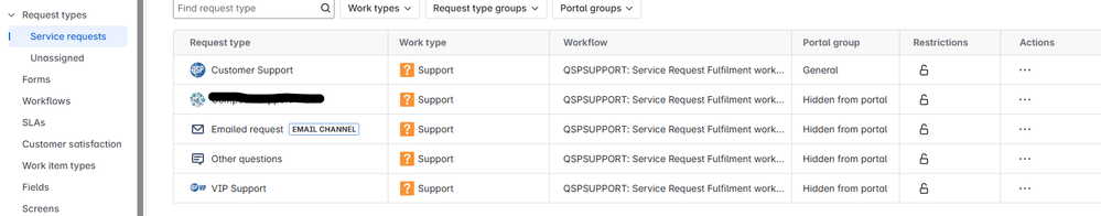

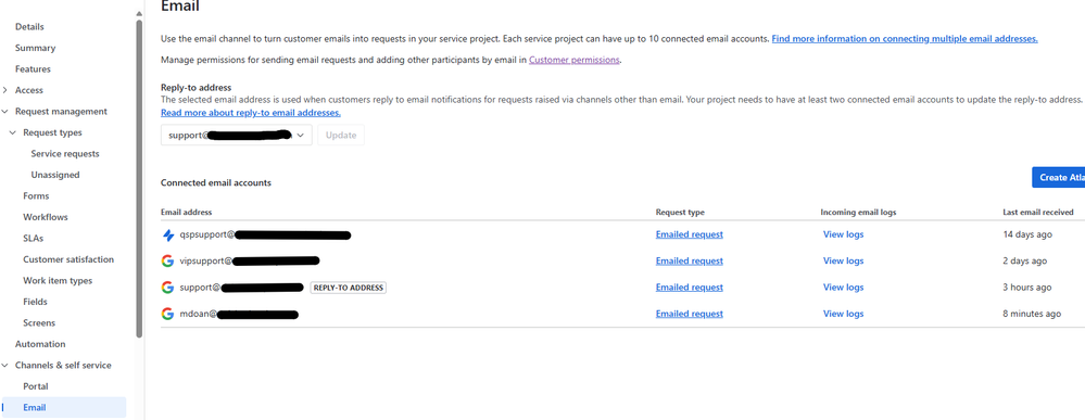

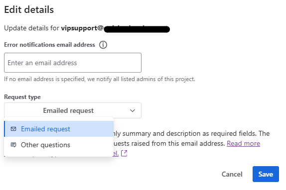

  3. When I go to remap the request type it only shows 2 options even though I have created more request types. Step 3.png
I tried undoing and redoing this and I am stuck
Marc - Devoteam
July 31, 2025
Hi @Dan Langenberg
I can pick any one of the request on my side.
Do keep in mind the request types can only have the fields Summary and Description, no other fields or a form.
Dan Langenberg
August 1, 2025
This ended up being the issue. Thanks for pointing that out. Now that I changed the fields I am able to select my new request types from the drop down.
