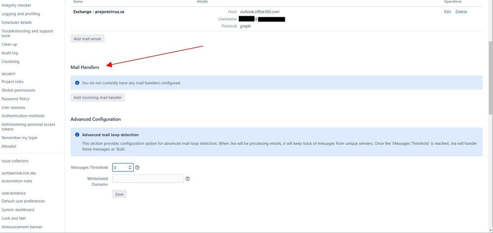

- The Incoming Mail section. Most advice on Internet suggest to set it up. But for JSM email requests it goes through JSM mail handler that is different. Here is a screenshot of our Incoming Mail settings:
screencapture-kadensis-atlassian-net-secure-admin-IncomingMailServers-jspa-2024-06-13-19_09_07.png

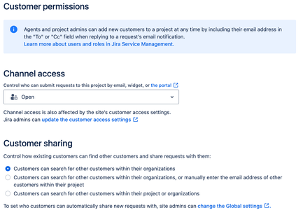

- Customer permissions:

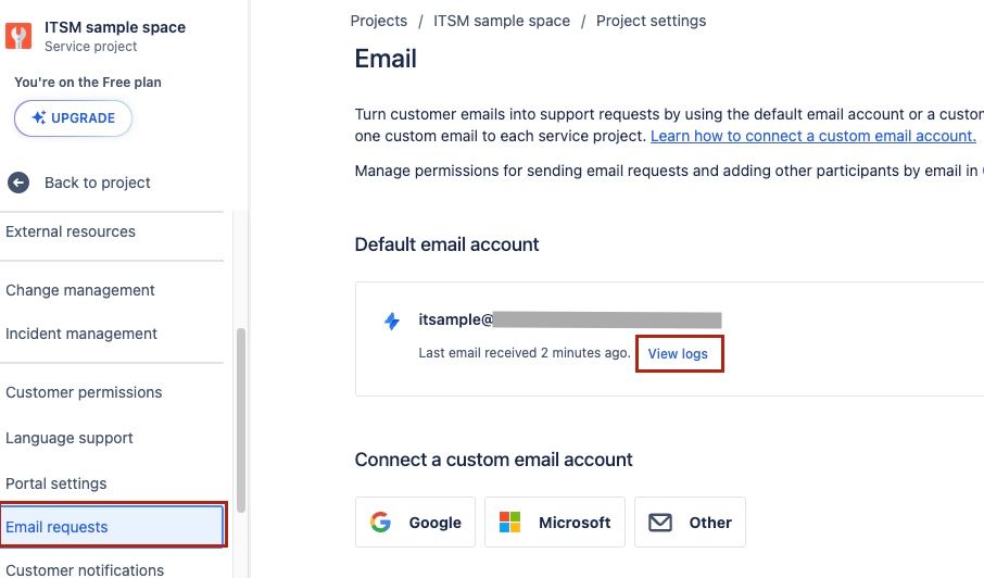

Can you also check the project's email requests logs?
Go to Project settings --> Email requests, and then View logs:

Hi! I have checked the logs indeed. I cannot put a screenshot since there are many emails in there, but the logs are fine. Each request is logged as "new request".

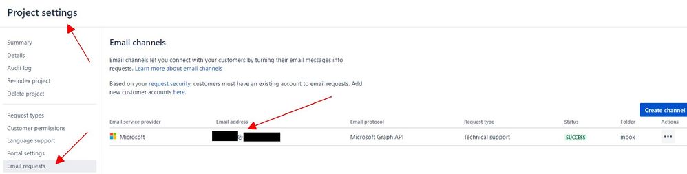

@Solène I was able to resolve my reported issue: Having a default System incoming mail handler is set to the same incoming email as a JSM project caused a Race Condition.
I resolved it by simply  removing the System Handler and leaving the setup in the Project email setting.
- I think the main cause of this, when you follow the JSM setup instructions they instruct you to setup the System incoming email handler by default.
Notes:
Make sure that you only delete a conflicting email handler (If you have more than one project with other email associations)  in the system portion as you may have others used for specific automation (ours was a default catch all for creations and comments for the same email address set for the project as explained above - Simple.)
My 2 cents:
If you delete something, make sure you can recreate it and know what was deleted, in the event you have other elements depending on this handler.
See Captures:
