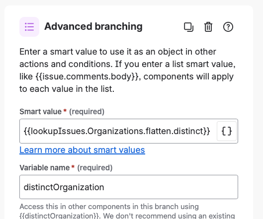

6. PROBLEM - the automation sends same amount of emails as the number of tickets for that org. For example, if I have Org A with 1 ticket, Org B with with 2 tickets, and Org C with 3 tickets, I am getting 1 email for Org A, 2 identical emails for Org B, and 3 identical emails for Org C.
7. Problem of dups disappears when I change Advanced Branching Smart Value
from:
{{lookupIssues.Organizations.flatten.distinct}}
to:
{{lookupIssues.Organizations.flatten.name.distinct}}
How to fix and avoid getting duplicate emails when using {{lookupIssues.Organizations.flatten.distinct}}?
Reasoning for why I cannot just fall back to {{lookupIssues.Organizations.flatten.name.distinct}} which works fine, no dups: I also need the Org's Id and I don't see the way to extract it when iterating over Org's name, I need to iterate over Org's object.

I suspect the problem is the flatten and distinct functions are having difficulty because Organizations is an object and has several attributes...rather than a single value.
Thus a workaround would be to use advanced branch over a single, flattened attribute, such as the Organization ID, and then within the branch, repeat the lookup and add the branch variable (i.e., the ID) to the JQL:
UPDATE: It appears the Organizations smart value is one which is loaded just-in-time, and thus cannot be used as I first suggested.  I confirmed this with testing both my original and the revised approach.  Either the entire object must be referenced and it will be looked up later; or all the orgs must be extracted into a created variable, and then parsed into a list for iteration.  The first approach is easier:
and within the branch, perhaps using the branch variable named varOneOrg added to the JQL:
AND Organization = {{varOneOrg.id}}

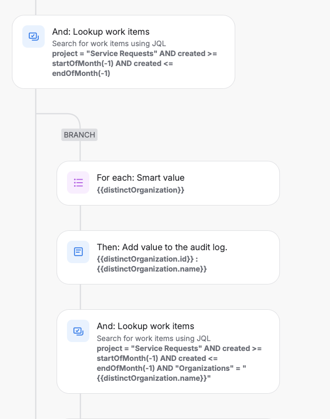

Thanks for your rule image, and after testing I found Organizations appears to be one of the smart values loaded just-in-time, the same as subtasks and issuelinks.  Thus it cannot evaluate fast enough for the id to be parsed out before the flatten and distinct happened in my original suggestion.
My original suggestion would only work if all of the orgs were first parsed into a created variable...forcing their evaluation.  And then flattened and examined with distinct.  As that seems unnecessary as the name and id are not needed until later, using the object directly in the branch seems to work.
For the updates you show, are they working as you expected?

I am failing to see how to flatten on both name and id for the Organizations. The loop iterate over flattened and distinct names - no dups. The moment I reference organization's id, things get duplicated.
The closest I am getting to the solution is getting the string of pairs as in name1:id1|name2:id2 which includes all the dups and then I need to parse it with some wild regex with name as parameter and get first match to extract the id. Working on it now.
That will keep me in the flattened name loop w/o referencing id that triggers dups.

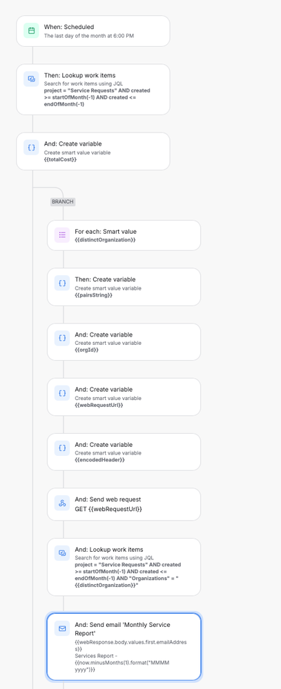

OK NAILED IT!!! GAH!
Inside the FOR EACH LOOP:
1. Create variable pairsString = {{#lookupIssues.Organizations.flatten}}{{name}}={{id}}|{{/lookupIssues.Organizations.flatten}}. It creates a string of org=id pairs with dups divided with I.
2. Parse it as the following orgId = {{pairsString.substringAfter(distinctOrganization).substringBefore("|").substring(1)}}. First gets what's after the matched Org name, then trims the tail leaving =Id, the substring(1) removes the = sign leaving me with the resulting orgId.
3. Now I have org Id in hand so I can issue REST request to get the customer email.
Gosh, unfreakingbelieavable! To get organization's customer email I needed to jump through insane hoops of string concat's and parsing then issue REST requests (now I need to manage tokens that will break my automation when they expire).
Is it really such a corner case? Here is Org name, give me the Org's customer's email.
Thanks for support and the ideas Bill!

When I did an advanced branch over the flattened and distinct Organizations, I was able to get the id directly.  I wonder what is difference for our usages.
  • advanced branch
    • variable name: varOneOrg
    • smart value: {{lookupIssues.Organizations.flatten.distinct}}
      • inside the branch, needing the {{varOneOrg.id}} to make the REST API call...
      • send the email...
I suspect it was the timing / just-in-time read thing I noted, where the branch did not get the data fast enough.  This can also happen in the Send Web Request action when the request URL or message body uses smart values; to solve that, one also uses a created variable to pre-evaluate them and then use the variable in the later action.

Alik Levin
December 14, 2025
Bill, would this work?
For Each uses {{lookupIssues.Organizations.flatten.name.distinct}}

That would likely work, although I would use the organization's ID to ensure the JQL works as expected.  And...I was recommending to include more information when asking future automation questions.
Did I misunderstand as I thought you had already solved this based on your earlier posts?
Alik Levin
December 14, 2025
Yes, I solved it through string concatenations and string parsing to eliminate dups, it is solved.
