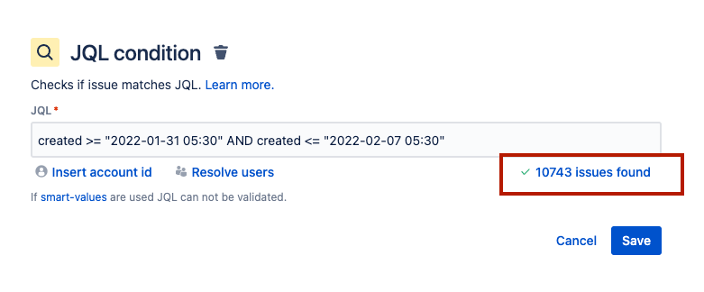

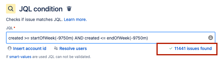

I am trying to get the same results for both of these JQLs, so it's Monday 5:30 AM to next Monday 5:30 AM, so I guess we need to change (-9750m) to align with Monday 05:30 AM as Jira counts Sunday as the start of the week?

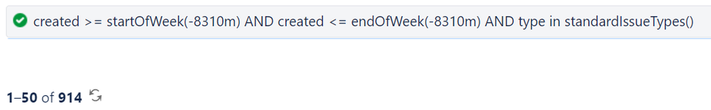

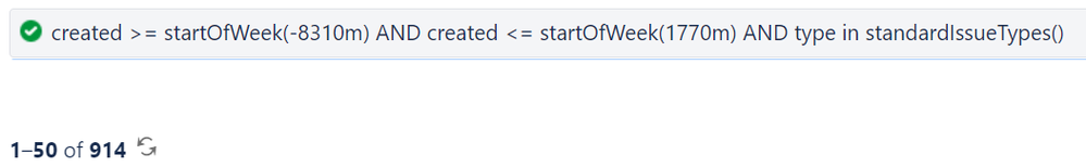

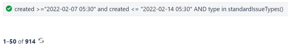

Have you checked the last proposed version? In my tests it works as intended ( "type in standardIssueTypes()" added in each version just to limit created issues below 1000+) :
  • Static version:
  • Dynamic version 1:
  • Dynamic version 2:
