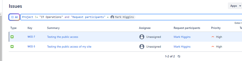

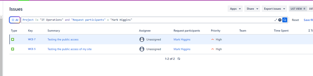

Replicating your query:
project = PJ1 AND Organizations = "Organization AS" AND "Request participants" != "User A"
I tried putting my name in quotes, and it happily returned the results I expected:
So its consistent using my name or Atlassian ID.

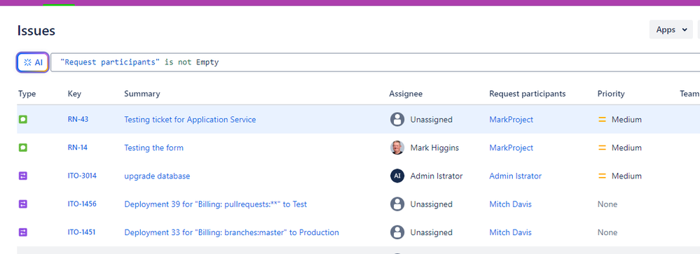

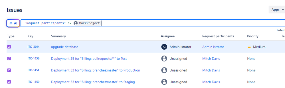

So I started with a straight query of 'Request participants" is not EMPTY

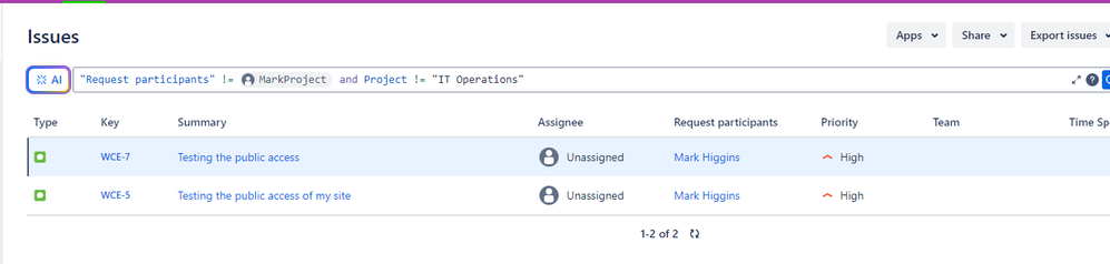

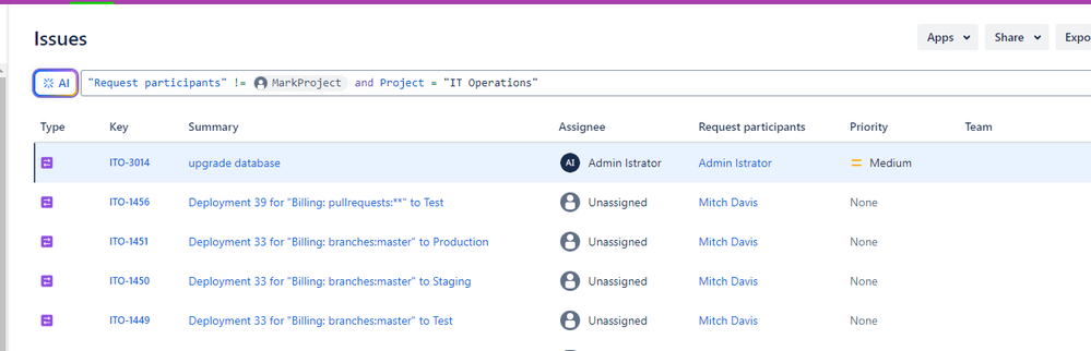

Then I changed it , so that it does not grab MarkProject.
Which worked as expected?
