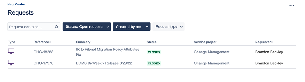

The JQL that is used to pull issues into the JSM Portal needs to be modified. It is pulling tickets with the status of Closed when looking for Open.
Is it possible to modify the JQL so it looks for the status of issues?
Here is a snapshot of what I mean.
If you look at the request in Jira, not the Portal, is the resolution set on those closed ones? The Portal filter will show them if the resolution is not set, that is how Jira determine if a request is done or not.
I am needing this for the Portal.
Yes, I have seen that Jira goes by the resolution field, but these two tickets were closed without a resolution. Therefore, I would like to modify the JQL used for the portal to search for the status of Closed. Is this possible? Or how can I get a Resolution added once an issue is in the status of Closed?
The JQL used on the portal cannot be changed. What you can do is add a transition in your workflow that sets the resolution as described in this KB, Best practices on using the "Resolution" field. Another option is to create an automation that sets the resolution for you, either as a scheduled one or an manual one.
Thanks Mike. I implemented the fix from the article, and all is good.

Based on your reply against @Mikael Sandberg suggestion, the root problem is that it seems (for those two specific issues) the WF used is not configured properly.
Typically, the WF configuration where issues transition into the terminal status, it is there the resolution value is set. Resolution value should never be controlled outside the WF. There may be also a possibility where the project has an automation rule (outside of the WF) configured in properly.
I would recommend you to review your WF configuration and ensure that the issue transition to the terminal status, the resolution value is set properly.
To fix your two existing "CLOSED" issues, you need to re-open it and re-close it again after you have your WF corrected where when moving issues to the CLOSED status has the resolution value set.
