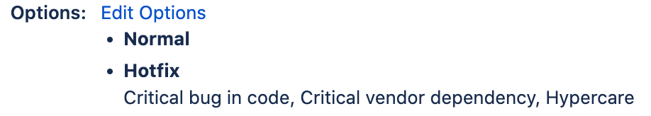

One of the Cascading options doesn't have a child option. The code mentioned will cause it to fail when this option is selected.
If user selects Normal, the JMWE should pass.
However, if Hotfix is selected without selecting a child option, it should fail.
Cascading field:
David Fischer
March 31, 2022
Unfortunately, you cannot check possible values in a Jira Expression (this is a Jira limitation). Therefore, you'll need to hardcode the value that doesn't require a child option:
!!issue.customfield_12345 && (issue.customfield_12345.value == "Normal" || !!issue.customfield_12345.child)
