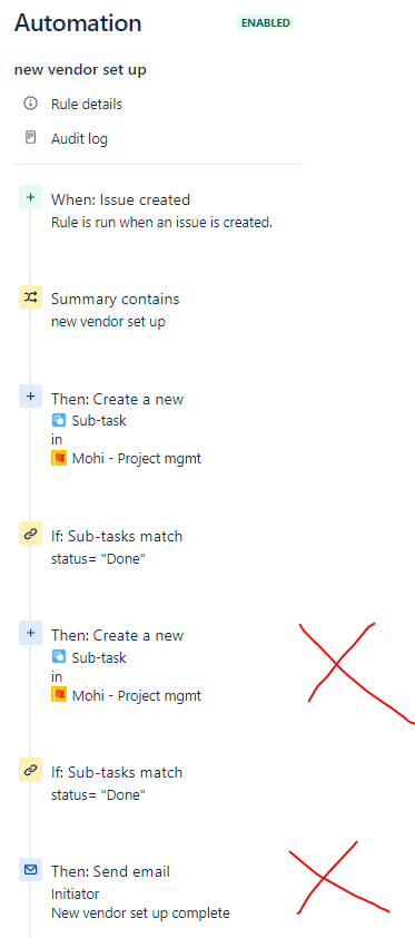

@Ivan Lima  Thank you for taking time to respond to my question. The reason I want to create sub-tasks sequentially is because each of these tasks have a different owner and want to notify owner 2 (for sub task 2) once the owner 1 (completes sub task 1). I want to automate this process to be enable something as shown below
The rule doesn't execute after the "Sub-Task 1" is created. I know this is not set up the best way, but the snippet below pretty much summarizes my use case (i.e. New Vendor Set Up)

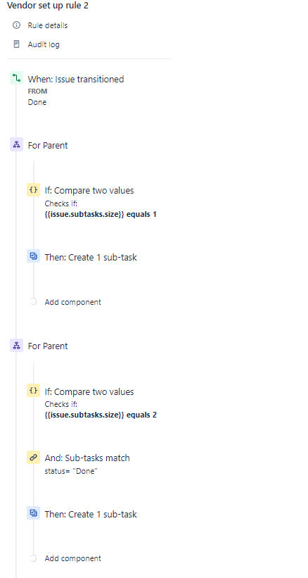

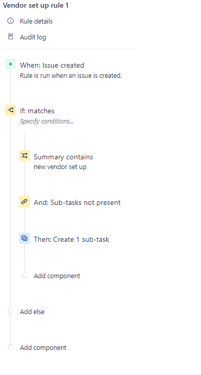

Amroz
November 2, 2021
@Ivan Lima  - Thank you so much for a detailed explanation. My rule #1 works and creates a sub-task as expected but my rule #2 doesn't get triggered

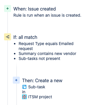

Rule #1 (example)
ac-1.png For the first rule, you can have your "If block" with all conditions you need. You can add conditions to your existing block. It should make it cleaner—also, fewer steps to execute, making it easier to troubleshoot by checking the automation rule audit log.

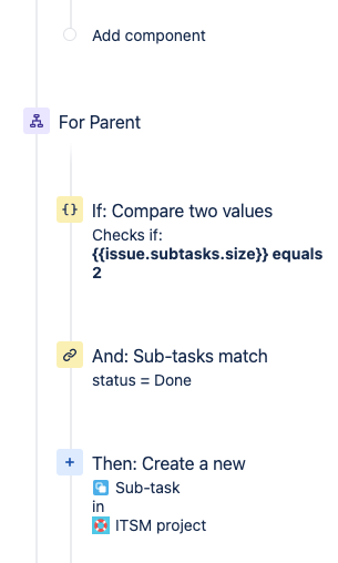

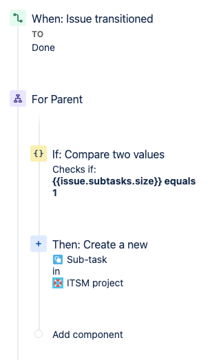

Rule #2(example)
For the "When" trigger, you should set TO, not FROM
You can create a new sub-task; you don't need to specify the number in this case. It shouldn't make any difference, but you can select "add fields" inside your action "Create sub-tasks" and include additional fields such as the assignee, as you mentioned before.
For the second part of rule #2, you need to check whether the status is done; otherwise, it will create all subtasks at once, which you don't want to happen.
